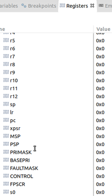

There is no SCB or NVIC register, the only ones I see are:
s0 is followed up with registers up to s31.

all others just show 0s which I find odd.

It seems everything is crash. All registers is zero.
NVIC and SCB register can't be read in that window. You can read them in memory window by input address.

I have the same situation now, KDS stopped, "No source available for "__isr_vector() at 0x0", All registers are 0x0 but in the disassembly window I now have:
