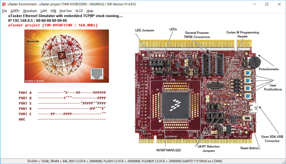

The KV58 is an advanced Cortex-M7 part which is not used by many people. It is not included in the Open Source version and only a basic (untested) port is presently available in the developer's version(!)
I don't have a TWR-KV58V220M and so have only simulated it (see below):
Although many modules are compatible with other parts, the KV58 has various new ones that are unique to it, which i haven't integrated. Since the module addresses do get moved around between different devices I expect that the basic port (which will do UARTs, Ethernet, port interrupts, low power modes, PITs, LPTMR, FlexTimers ad maybe a few more such generic modules) will probably fail on first attempts on the HW since something hasn't been spotted yet that needs a special setting. Sometimes it does work on first attempt but the KV58 is rather complex so the chances are lower. Fixing such things is easy though, but needs the HW tests to show it.
I'll give you access to the developer's version (which will simulate and run on around 80 development boards) so you can have a look at it and if you feel up to it you could see whether you can get the KV58 tweaked to work. I'll send you my email too so you can inform me of any issues so that I can point you in the correct direction at the beginning.
