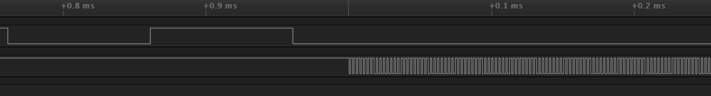

In the uTasker project I can do this:
1) Configure two port outputs for test purposes:
extern void fnUserHWInit(void)
    _CONFIG_DRIVE_PORT_OUTPUT_VALUE(C, (PORTC_BIT3 | PORTC_BIT4), (PORTC_BIT3 | PORTC_BIT4), (PORT_SRE_SLOW | PORT_DSE_HIGH));
2) Configure a 100us SYSTICK with high priority:
#define _TICK_RESOLUTION     TICK_UNIT_US(100)
#define SYSTICK_PRIORITY           1
3) Configure an input with level sensitive interrupt at lower priority
#define PRIORITY_PORT_A_INT        6
static void fnInitIRQ(void)
    INTERRUPT_SETUP interrupt_setup;                             // interrupt configuration parameters
    interrupt_setup.int_type       = PORT_INTERRUPT;             // identifier to configure port interrupt
    interrupt_setup.int_handler    = test_irq;                   // handling function
    interrupt_setup.int_priority   = PRIORITY_PORT_A_INT;        // interrupt priority level
    interrupt_setup.int_port       = PORTA;                      // the port that the interrupt input is on
    interrupt_setup.int_port_bits = PORTA_BIT10;                 // the IRQ input connecte
    interrupt_setup.int_port_sense = (IRQ_LOW_LEVEL | PULLUP_ON);// interrupt is to be low level sensitive
    fnConfigureInterrupt((void *)&interrupt_setup);              // configure interrupt
4) In the SYSTICK interrupt handler I toggle one port each times it enters and in the IRQ handler I toggle the other port on each entry:
static __interrupt void _RealTimeInterrupt(void)
    _TOGGLE_PORT(C, PORTC_BIT3);
static void __callback_interrupt test_irq(void)
    _TOGGLE_PORT(C, PORTC_BIT4);
When I run this and press the input with level sensitive input this is the output that is recorded:
As can be seen, the 100us SYSTICK is still executed even when there is a continuous level sensitive interrupt on the input due to the fact that it has a higher interrupt priority and takes priority when both are pending and it also pre-empts the port interrupt handler.

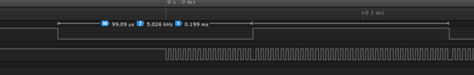

If I then do
#define SYSTICK_PRIORITY           7
the result is
where it is seen that the SYSTICK interrupt is not called any more due to the fact that the port interrupt is always pending and has priority.
