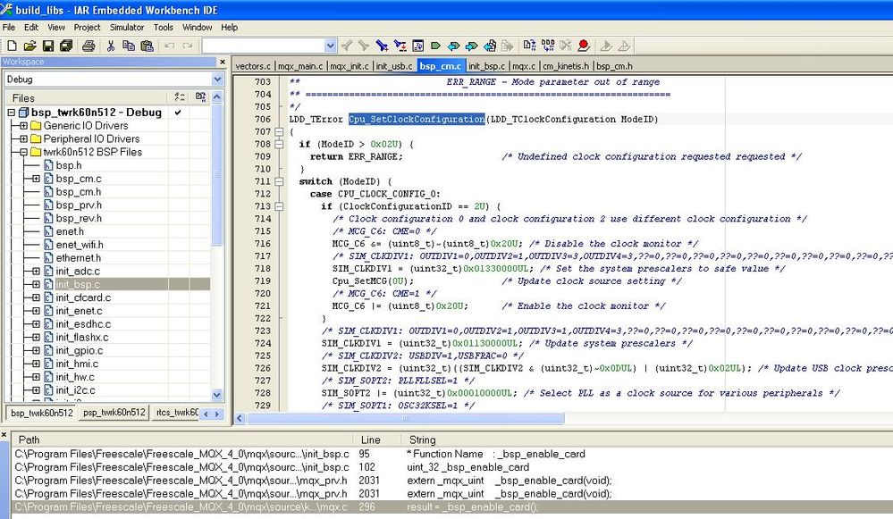

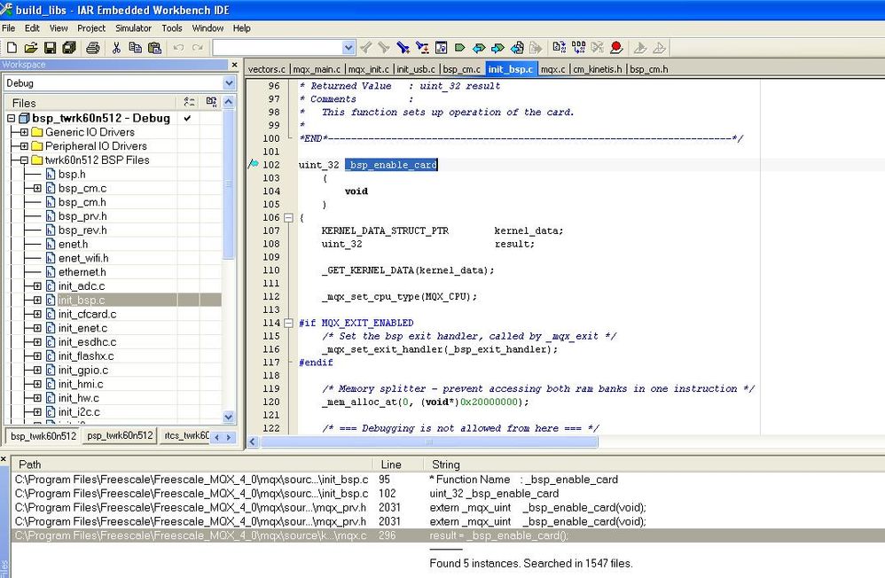

You may find the MQX initialisation in mqx.c, in which there is a function named as "
_mqx_uint _mqx
    register MQX_INITIALIZATION_STRUCT_PTR mqx_init
it performs brief initialisation and starts MQX on the processor. For BSP-specific initialization, it is done in _bsp_enable_card(), which can be found in init_bps.c . Please refer to following for details.
The clock configuration can be found in Cpu_SetClockConfiguration() in bsp_cm.c.
there is also a definition for clock configuration, which can be found in BSP_CLOCK_CONFIGURATION, bsp_cm.h
_mqx_uint _mqx
