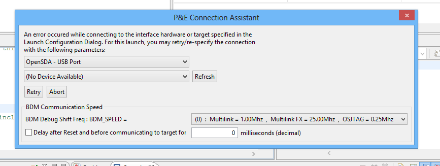

Hi, I am new in this of the kinetis microcontroller, and i have the FRDM KL25Z but when i wanna debbug, codewarrior shows  a error alert....Can somebody help me please??...

Hi Jose,
have you switched to the SDA debug application? It looks like you are running the wrong firmware for debugging.

LuisCasado
By default the firmware running in the OpenSDA device is the MSD, you have to program the debug application into OpenSDA.
Follow the OpenSDA User Guide.
http://cache.freescale.com/files/32bit/doc/user_guide/OPENSDAUG.pdf?fpsp=1&WT_TYPE=Users Guides&WT_VENDOR=FREESCALE&WT_FILE_FORMAT=pdf&WT_ASSET=Documentation
  1. Getting into Bootloader Mode
  2. Program the P&E Debug Application
Then CW will detect your debugger device.

josealonsovalle
Thanks bro, already i can debbug my board....
