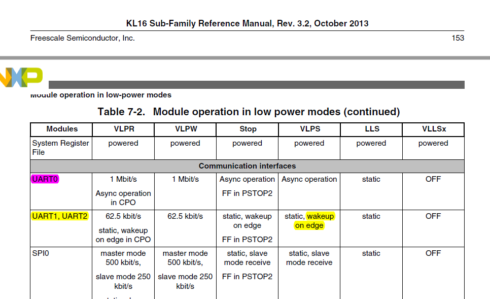

Hi Mark,
Thanks for the info. However, our board has been made already.
We chose UART0 not realizing we cannot use it for wake up on edge (according to the reference manual below).
Wake up on edge is only available on UART1 and UART2.
That is why I posted my question on using UART0, if it can be done using UART0 (wake up from VLPS) then we don't need to re-spin our board.

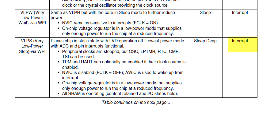

     1. How do you wake up a KL16 from VLPS (Very Low Power Stop) mode using UART0?
      You just need to know, the VLPS recovery method, you can find it from the reference manual:
It is the interrupt, so if you want to use the UART0 to wake up it, you just need to enable the UART0 interrupt, then when the UART0 happens, the MCU will be waked up.

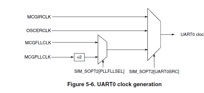

2.Can I clock it using the LPO since it is the only clock available and still ON during VLPS mode?
  You need to check, whether the LPO can be the UART0 clock source:
You can find no LPO can be selected.
But don't worry, you can use the MCGIRCLK, this clock also works in VLPS mode.
