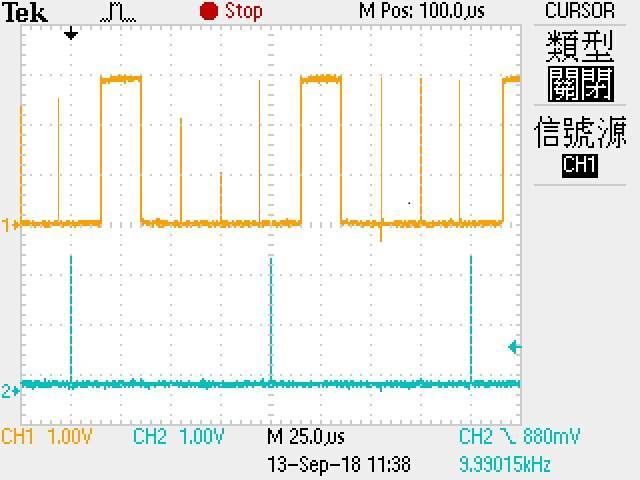

Dear NXP ,
   I Follow this : PWM Duty Cycle Issue - Kinetis L ( MKL26Z128 )
   And we use FRDM-KL02Z , found that when we modify C0V = 1 will happen a Full Duty waveform
   So we supply thePWM Duty Cycle Issue - Kinetis L ( MKL26Z128 ) to customer and let them avoid " 1 " value into C0V
   Have any document about this ? ( Errata sheet ) Customer need this .
   and whether this will make other module fail ? ( ADC ? UART ? any others )
   this issue happen in KL02Z , How about other KL series ic ? Has already fix this ? Thanks a lot !!

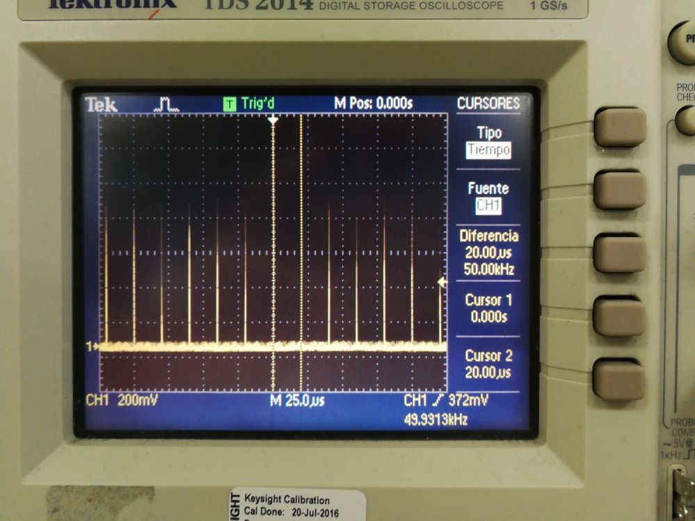

victorjimenez
Could you please provide more information, for example: at what frequency are you working? where in your program are you changing the duty cycle, in the interrupt or in another place?
I tried the example tpm_simple_pwm of the SDK along with the FRDM-KL02Z board. I modified the code to see the signal in a oscilloscope and I wrote "1" directly to the CnV register and everything worked fine.
I checked the errata and there is no information available regarding the behavior that you mentioned. Could you please try with the example of the SDK?
Victor.

ellenlin
Dear  Victor Jimenez :
   Provide Code Warrior project to you ,
   We use TPM1 Interrupt to modify TPM0 Duty Cycle , AND This happen ,
   you can try attachment file in Code warrior IDE , THANKS!!

ellenlin
Dear Victor Jimenez 員工
   My Customer has already use CW for several years ,
   it ' s not a good choice to change IDE , Their FW Team is too large and they don't prefer this , they want a document to explain this issue .
   I use TPM1 ( Period = 100uS ) Interrupt to modify TPM0 ( Period = 20 us ) Duty cycle .
   Really need NXP 's Support to check this , thanks a lot !!

victorjimenez
Thanks for providing more information. I ran the project that you provided and I was able to reproduce the behavior that you mentioned. However, I noticed that once I stopped the debug session the program starts to function as expected, see photo below.
It seems that the behavior is due to the debug session. In runtime, you can write one to the CnV register without any problem.
Victor.

victorjimenez
When I ran your project from the debug session even if I use free run I could reproduce the behavior you mentioned. However, once I stopped/exited the debug session completely and restart the board the behavior was gone and the program was running as expected. I couldn’t reproduce the behavior while running your project without an open debug session. The behavior you are facing is due to the debug session of code warrior, not the MCU, so there are not available errata for this since the problem is not from the MCU. I’m still investigating how the debug session is messing with the time of the peripheral TPM.
Hope it helps!
Victor.
