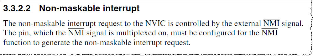

steetven_er45yer
Hi,Robin_shen
      i use PB4 as MISO. When I download the program to the MCU, it can work normally. But after re-power on, MISO no longer receives external changes. Then I transplanted the MISO function to PB3, and the function was normal after power on. Can you help me analyze where the problem is with the configuration?
This is my configuration about SPI
3,234 Views
Robin_Shen
Hi steetven,
The PTB4 pin defaults to the NMI_b function.
Driving the NMI signal low forces a non-maskable interrupt, if the NMI function is selected on the corresponding pin.
It is not recommended to use this pin for other functions.
If you must use this pin, you need to configure SIM_SOPT[NMIE].
