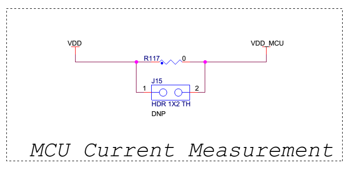

I'm test the low power mode static current consume in STOP mode with FRDM-KEAZ128Q80 board and demo project--FRDM_KEA128_PMC.zip in S32DS for ARM version from the demo board's Quick Start Package---FRDM-KEA-QSP, attached for your reference. but I got over 220uA( measured with my multimeter )  at jumper J15 with R117 removed, during the STOP mode period in the first 3 seconds as the project configured:

the J15 jumper circuit(I also attached the complete schematic for your reference) for MCU current measurement on FRDM-KEAZ128Q80:

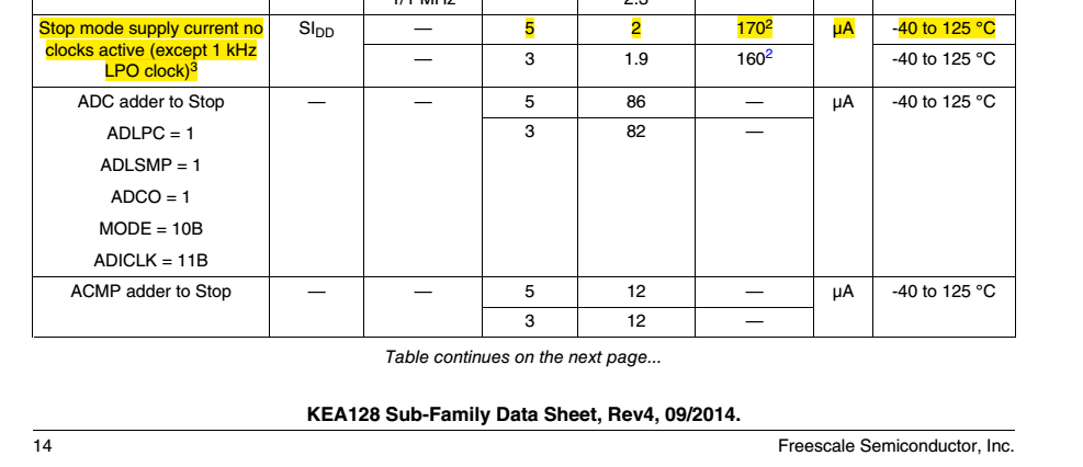

I get the STOP mode current parameters from KEAZ128 datasheet(S9KEA128P80M48SF0, KEA128 Sub-Family Data Sheet - Data Sheet (REV 4))as below:
its typical STOP mode current should be 2 uA, so my test result has big gap.

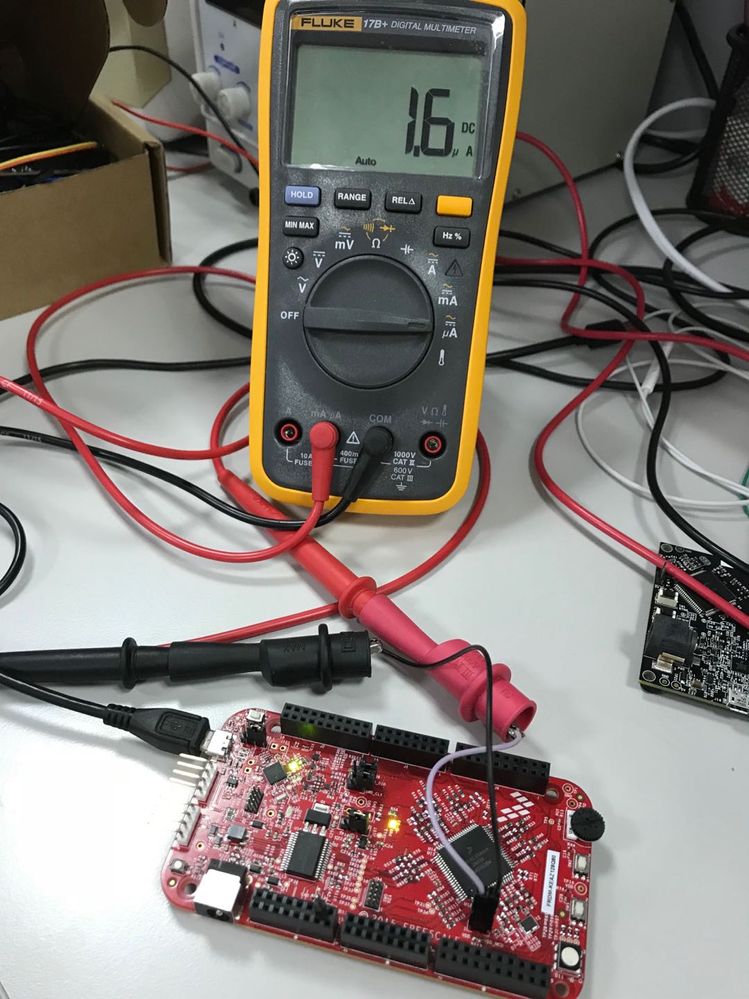

kerryzhou
Hello nicky,
    Please check this test result:
1.6uA in stop mode, meet the datasheet's data.
Please follow me to realize it.
1. Board hardware configuration.
Remove the R117,cut the wire between J8, J106,
2, Download my attached project, which enter the stop mode.
 At first, you need to use jumper to connect J8 and J106, just to download the code.
After you download the code, please remove the jumper between J8 and J106, this is very important.
My attached code is the S32DS project, it's modified from the FRDM-KEA128 driver code.
3. After download the code, please power off the board, then power on it again, this is very important.
After the above 3 points, you can test the power consumption in J15,  you will find the current consumption is 1.6uA.
Please check it on your side, I already make it work.
Wish it helps you!
If you still have question about it, please kindly let me know!
Kerry

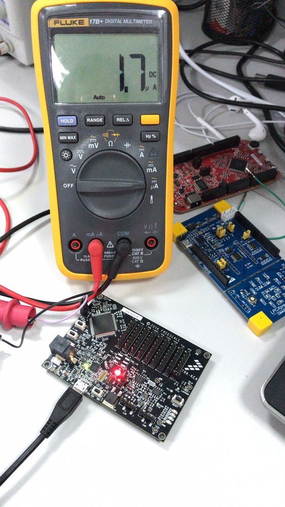

ruijuzhang
I use TRK-KEA128 REV D,Remove R76,measure result is  about 250uA,why?

kerryzhou
Hi Ruiju,
     Use my test code in the above reply, download the code, then power off the board, power on it again, then test the power consumption.
     I also have tested the TRK board, the power consumption is correct.
Kerry

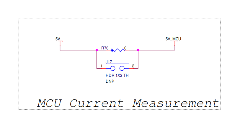

ruijuzhang
 I did what you say.
Differences:
you say: TRK-KEA128 (REV D)is very simple, find J17, remove R70, put your current meter in J17.
I remove   R76 .
8,296 Views
kerryzhou
Hi RuiJu,
    Sorry, it's absolutely my mistyping, yes, it should be R76, thanks for pointing out it.
    After you download the code, do you power off the board, and power on it again? Don't just use reset button.

   About the TRK-KEA128, yes, I already test it when I do the FRDM-KEA128 STOP test yesterday,  TRK-KEA128 (REV D)is very simple, find J17, remove R76, put your current meter in J17, then download my code(then same as the FRDM-KEA128), power off the board, and power on it again, you will get the according current consumption, you can test it on your side.
