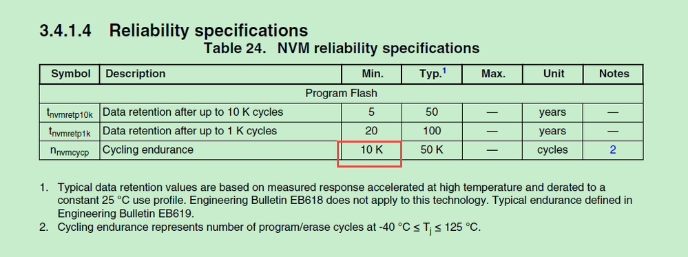

how many times can i programming a MKL16Z256VLH4?

hi, someone knows, how many times can i programming a MKL16Z256VLH4? or what is its life time?

   SCOTT MILLER is correct. Please refer to the KL16 datasheet.

The data sheet (3.4.1.4) says it's rated at a minimum of 10,000 cycles, and typical is 50,000 cycles.  Engineering bulletin EB619 has more details.
