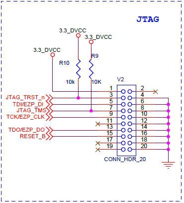

anjum
Hello Alice,
I have attached the image of the jtag interface we are using.I have tried programming the K60 board pulling up the TDI pin also.But same programming error appears.The reset_b and EZP_CS pins are high. Earlier two or three times we programmed the processor without mass erasing it intially,so i hope the jtag interface is correct.But not now, the above said error appears.Please help.
1,963 Views
Hello ,
You said some days before it can work well , and you if you have not change the  board ,
it maybe the configuration have some problem when debug , please take a screenshot .
And please check the "Device Manager" of computer , check whether it detect it when you connect the board.
And you  can also connect the PIN2 to power to have a try .
