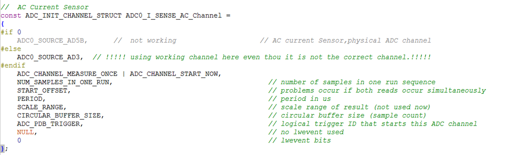

I'm having problems when I use the ADC0_SOURCE__AD5B channel in the below structure.
The code works if I use the ADC0_SOURCE_AD3.   I know that the muxsel must be set to B for the AD5B channel.
Is there any known issues with this channel?

     I find a disorder in your header file:
//  3.3V Current Sensor const ADC_INIT_CHANNEL_STRUCT ADC0_I_SENSE_3_3V_Channel = {     ADC0_SOURCE_AD3,                                            // 3.3V Current Sensor,physical ADC     ADC_CHANNEL_MEASURE_ONCE | ADC_CHANNEL_START_NOW,               NUM_SAMPLES_IN_ONE_RUN,                                     // number of samples in one run sequence                  START_OFFSET,                                               //     PERIOD,                                                     // period in us                                           SCALE_RANGE,                                                // scale range of result (not used now)                   CIRCULAR_BUFFER_SIZE,                                       // circular buffer size (sample count)                    ADC_PDB_TRIGGER,                                            // logical trigger ID that starts this ADC channel        NULL,                                                       // no lwevent used                                        0                                                           // lwevent bits                                       };
//  5V Voltage Sensor const ADC_INIT_CHANNEL_STRUCT ADC0_VOLT_SENSE_5V_Channel = {     ADC0_SOURCE_AD1,                                            // 3.3V Voltage Sensor,physical ADC channel     ADC_CHANNEL_MEASURE_ONCE | ADC_CHANNEL_START_NOW,               NUM_SAMPLES_IN_ONE_RUN,                                     // number of samples in one run sequence     PERIOD,                                                     // period in us                                           START_OFFSET,                                               //     SCALE_RANGE,                                                // scale range of result (not used now)     CIRCULAR_BUFFER_SIZE,                                       // circular buffer size (sample count)     ADC_PDB_TRIGGER,                                            // logical trigger ID that starts this ADC channel     NULL,                                                       // no lwevent used     0                                                           // lwevent bits };
//  AC Current Sensor const ADC_INIT_CHANNEL_STRUCT ADC0_I_SENSE_AC_Channel = { #if 0     ADC0_SOURCE_AD5B,      //  not working                    // AC current Sensor,physical ADC channel #else      ADC0_SOURCE_AD3,  // !!!!! using working channel here even thou it is not the correct channel.!!!!! #endif        ADC_CHANNEL_MEASURE_ONCE | ADC_CHANNEL_START_NOW,     NUM_SAMPLES_IN_ONE_RUN,                                     // number of samples in one run sequence                 START_OFFSET,                                               //     PERIOD,                                                     // period in us                                          SCALE_RANGE,                                                // scale range of result (not used now)                  CIRCULAR_BUFFER_SIZE,                                       // circular buffer size (sample count)                   ADC_PDB_TRIGGER,                                            // logical trigger ID that starts this ADC channel       NULL,                                                       // no lwevent used                                       0                                                           // lwevent bits                                      };
Why ADC0_VOLT_SENSE_5V_Channel, the defination of PERIOD, START_OFFSET is not like other channel?
Whether it should be :

I am not familiar with your mqx code, I just find the definiation has the difference, I don't know whether it has problem when you call : VOLT_SENSE_5V_INDEX
Besides, please also check the PORTx_PCRn[MUX], when the problem happens.

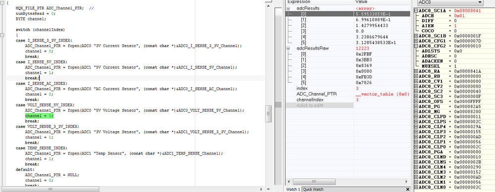

The above shows a break point set when the channel fails the fopen.   ADC_Channel_PTR = _vector_table(0x0):
Here is the same break point but this is for the working case.      ADC_Channel_PTR = 0x72183C30
The only difference between the two cases is that the failed case does not execute the below code:
if (channelIndex == I_SENSE_AC_INDEX)
            fclose(m_ADC0);
            InitADCModule_ADC0();

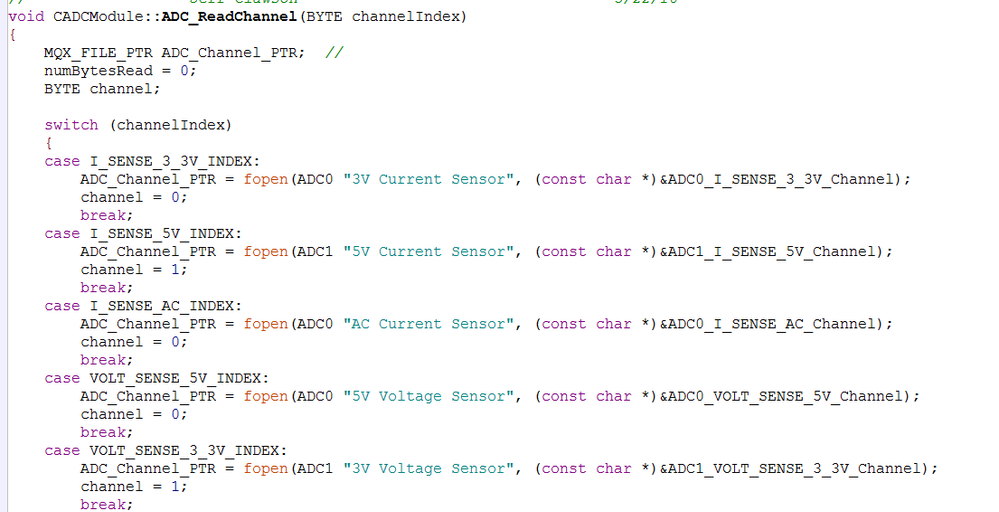

I got the code to work but I shouldn't have had to add the code that I did.
I added the following code to the end of the void CADCModule::ADC_ReadChannel(BYTE channelIndex) function.
            fclose(m_ADC0);
Without this code the next measured channel on the ADC0 channel would fail to open.
Why does the ADC0_SOURCE_AD5B channel measurement cause the next channel to fail to open.
case VOLT_SENSE_5V_INDEX:
        ADC_Channel_PTR = fopen(ADC0 "5V Voltage Sensor", (const char *)&ADC0_VOLT_SENSE_5V_Channel);
        channel = 0;
        break;
All the other channels work as they should.

    Could you tell me what the fopen function retrun when you call ADC_ReadChannel, channelIndex= I_SENSE_AC_INDEX in your code?
   What the ADC_Channel_PTR data value?
void CADCModule::ADC_ReadChannel(BYTE channelIndex) {     MQX_FILE_PTR ADC_Channel_PTR;  //     numBytesRead = 0;     BYTE channel;
    switch (channelIndex)     {     case I_SENSE_3_3V_INDEX:         ADC_Channel_PTR = fopen(ADC0 "3V Current Sensor", (const char *)&ADC0_I_SENSE_3_3V_Channel);         channel = 0;         break;     case I_SENSE_5V_INDEX:         ADC_Channel_PTR = fopen(ADC1 "5V Current Sensor", (const char *)&ADC1_I_SENSE_5V_Channel);         channel = 1;         break;     case I_SENSE_AC_INDEX:         ADC_Channel_PTR = fopen(ADC0 "AC Current Sensor", (const char *)&ADC0_I_SENSE_AC_Channel);         channel = 0;         break;     case VOLT_SENSE_5V_INDEX:         ADC_Channel_PTR = fopen(ADC0 "5V Voltage Sensor", (const char *)&ADC0_VOLT_SENSE_5V_Channel);         channel = 0;         break;     case VOLT_SENSE_3_3V_INDEX:         ADC_Channel_PTR = fopen(ADC1 "3V Voltage Sensor", (const char *)&ADC1_VOLT_SENSE_3_3V_Channel);         channel = 1;         break;     case TEMP_SENSE_INDEX:         ADC_Channel_PTR = fopen(ADC1 "Temp Sensor", (const char *)&ADC1_TEMP_SENSE_Channel);         channel = 1;         break;     default:         ADC_Channel_PTR = NULL;         channel = 0;         break;     }
    if (ADC_Channel_PTR == NULL)
        printf("Cannot open ADC Channel\n");
        fclose(ADC_Channel_PTR);
        if (channel == 0)
            fclose(m_ADC0);
        else if (channel == 1)
            fclose(m_ADC1);
            InitADCModule_ADC1();
Please do the debug step by step in your code when you are calling ADC_ReadChannel, whether other ADC channel will make ADC_Channel_PTR == NULL? I find your code when  ADC_Channel_PTR == NULL, then will do ADC channel fclose and init.
