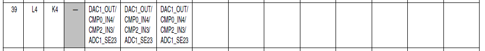

- On the other hand if you see the K64 manual then you would find this:
Then you can see that the pin does not have any digital function, only analog (DAC, Comparator and ADC).

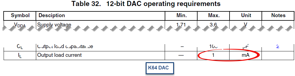

- Now if you intend to use the DAC low and high digital values conversion to emulate a digital output then I guess it is possible but not an efficient approach. Also as you mentioned pay attention not to exceed the max output load current as specified in the datasheet. Below an example for K64:
