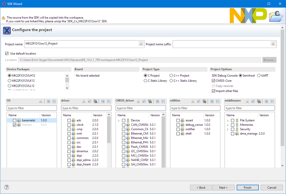

BlackNight
If you created the MCUXpresso SDK with FreeRTOS included, then you can create a project with FreeRTOS added ini MCUXpresso IDE:
I hope this helps,
Erich
