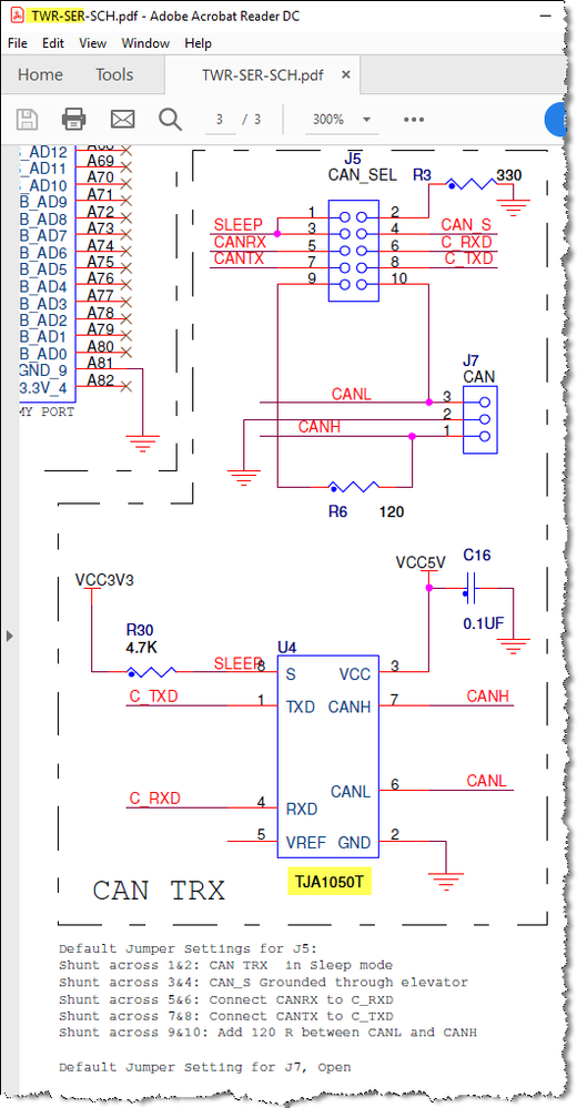

      I have 2 frdm k64 development boards and I am trying to use CAN bus for making communication happen between the boards. For this I tried flexcan_loopback example in MCUXpressoIDE_10.2.1_795. In the readme part it I saw that PTB16 and PTB17 are to be connected. I couldnt find the pins PTB16 and PTB17 in the board. Can I know from where the output of those pins## taken. Thank You.

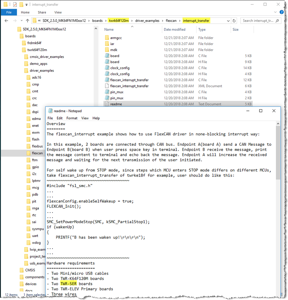

If you want to use CAN bus for making communication happen between the FRDM-K64F boards, CAN Transceiver is needed.
There is flexcan interrupt_transfer example in SDK_2.5.0 of twrk64f120m.
You can see this example need Two TWR-SER boards in readme file.(The CAN Transceiver is on TWR-SER board)
Robin
