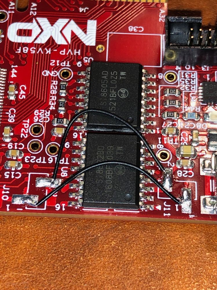

After reviewing, the schematics and probing some signals on the board, I found some answers:
1. The HVP-KV58F board can't attach to the MCUXpresso because the target MCU is not powered by the USB port like it is the case with the HVP-KV46F150M.
2. To power the MCU in standalone mode, you have to plug it into the HVPMC3P or you have to provide the power from the USB by wiring the power of the USB to power the target MCU via J10 and J11.  See the attached image.
IMPORTANT - You can't insert HVP-KV58F module into the HVPMC3P platform when this patch is installed.

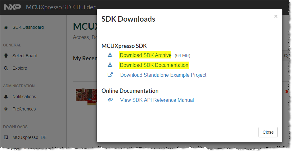

Please download the MCUXpresso IDE 10.3.0, CodeWarrior and Kinetis Design Studio are outdate.(New SDK will not support them.)
Please also build and download the latest MCUXpresso SDK_2.5.0_HVP-KV58F and Documentation(SDK_2.5.0_HVP-KV58F_doc).

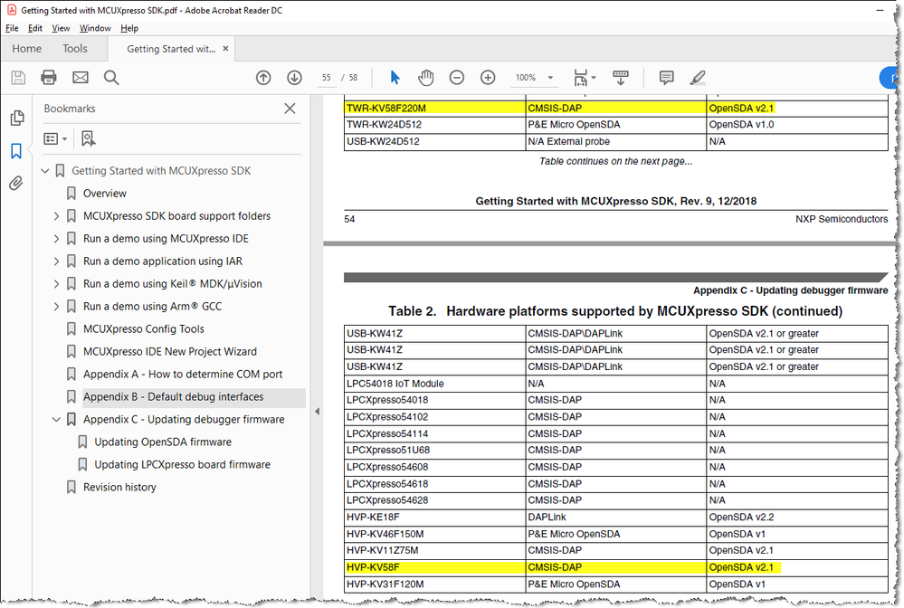

Then you can find the "Table 2. Hardware platforms supported by MCUXpresso SDK" Getting Started with MCUXpresso SDK.pdf.
It showns CMSIS-DAP OpenSDA v2.1 are used on both HVP-KV58F and TWR-KV58F220M.

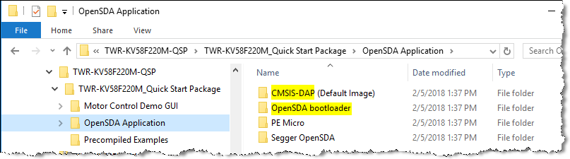

I have attached TWR-KV58F220M-QSP.zip, you can try to use the bootloader and firmware in it.(Win10 may meet problem.)

I have burned and tested the following OpenSDA images.
  • CMSIS-DAP (Default Image)
  • OpenSDA bootloader
  • PE Micro
  • Segger OpenSDA
The USB device is listed when I boot in bootloader mode.  Then I can copy the firmware onto the bootloader drive, but  I don't see the USB device when a disconnect and reconned the HVP-KV58F board to my MacBook Pro.
