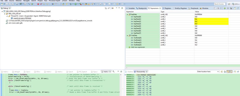

kerryzhou
Hi sruthy uk,
      Did you check my code? I already test it on my side, it can receive the data, the test result is like following:
    If your code still can't receive the correct data,  your configuration may still have problem, you can refer to my code.
