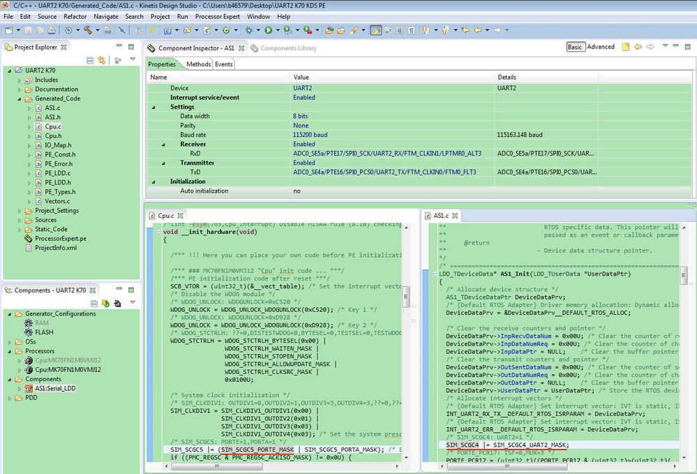

If you want to use UART2 and PORTE modules, you need enable their clock gates manually first.
The PE has enabled these clock gates automatically.
See below image:
Robin
