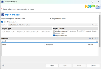

Celeste_Liu
Hello @RajPadmani ,
I couldn't find the bootloader example in the KM34 SDK.
Could you describe the problem in more detail? Also, how did you conduct the tests? Based on the current information you've provided, we're unable to pinpoint the problem.

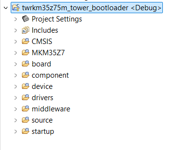

RajPadmani
There is no SDK example for the MKM34Z256VLQ7 bootloader, so I customized the MKM35 bootloader to run on the MKM34, and it worked perfectly.

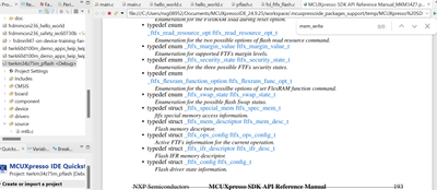

Celeste_Liu
To clarify the differences between the "mem_write" function and the "flash_program" function, I need to understand their specific implementation methods. Given that you are using a customized bootloader, I'm not sure how "mem_write" is implemented, and I haven't been able to find relevant content in the API Reference Manual either.
I wonder if you could send me this part of the code. If you have referred to any existing SDK projects or ANs, please let me know as well.

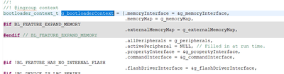

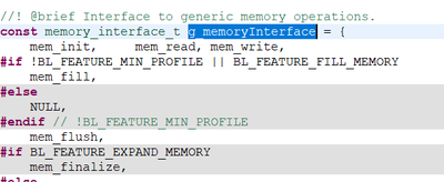

RajPadmani
I am using this bootloader in the KM34 microcontroller. In the bootloader code, I only changed the memory addresses to make it compatible with the KM34.
The mem_write function is a wrapper that uses the flash_program function to write to flash. However, it executes faster than the flash_program function, which I used directly in my application.
You can find this function in "bl_context.c"
In this file, there is a structure named g_bootloaderContext, which contains a structure variable called memoryInterface. The value of g_memoryInterface is assigned to it, and within g_memoryInterface, you will find the mem_write function.
