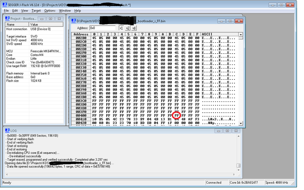

I'm having a very strange issue.
Even though the Flash Configuration Field (FCF) is at its default state:
/* Flash Configuration*/
.section .FlashConfig, "a"
.long 0xFFFFFFFF
.long 0xFFFFFFFF
.long 0xFFFFFFFF
.long 0xFFFFFFFE
Whenever I try to flash my (custom) board with Segger J-link I'm getting a secure alert (stating that the image causes the flash to be secured), and obviously when trying to delete app later on with KBOOT, I'm getting a message saying flash cannot be deleted since it is secured. This pop up is shown also with a 'regular app' located at address 0x00 (so no connection to KBOOT).

roymessinger
Contributor V
Hi kerryzhou‌,
I'm using K64.
I'm now facing another strange behavior. After the board security is disabled, I now cannot enable it again. I want to emphasize I do not want security (thus I do not want to use unlock), but I wanted to debug the error I explained above so I made 2 bin files. One with FE at FSEC register (0x40C) and one with FF.
When I load the FF bin file. I see it in the Segger flasher as follows:
You can see FF at 0x40C.
After I flash the file, it changes to FE (turned red):
So, I do not understand. If the register at CFC (address 0x40C) was set to FF, how come Segger changed it to FE?
Roy

kerryzhou
Hi Roy,
  Do you want to write the 0X40C to 0xff, then to secure the chip?
  If yes, please check this picture:
When you select the chip, you should select the chip MK64XXX(allow security), othewise, the chip will automatically modify the 0X40C to 0xfe.
Kerry
