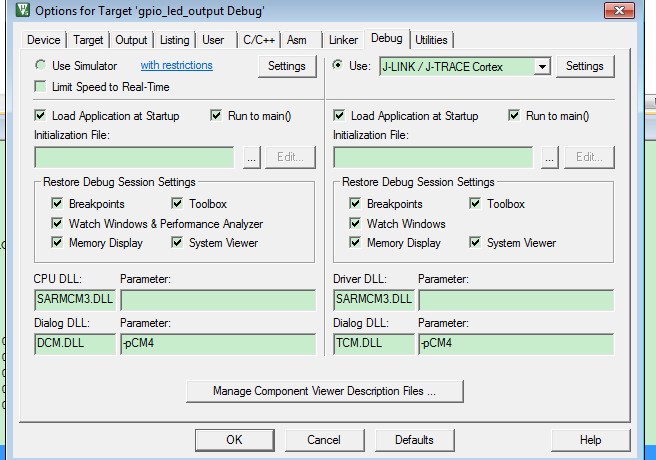

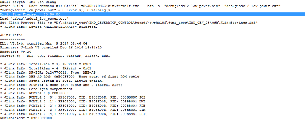

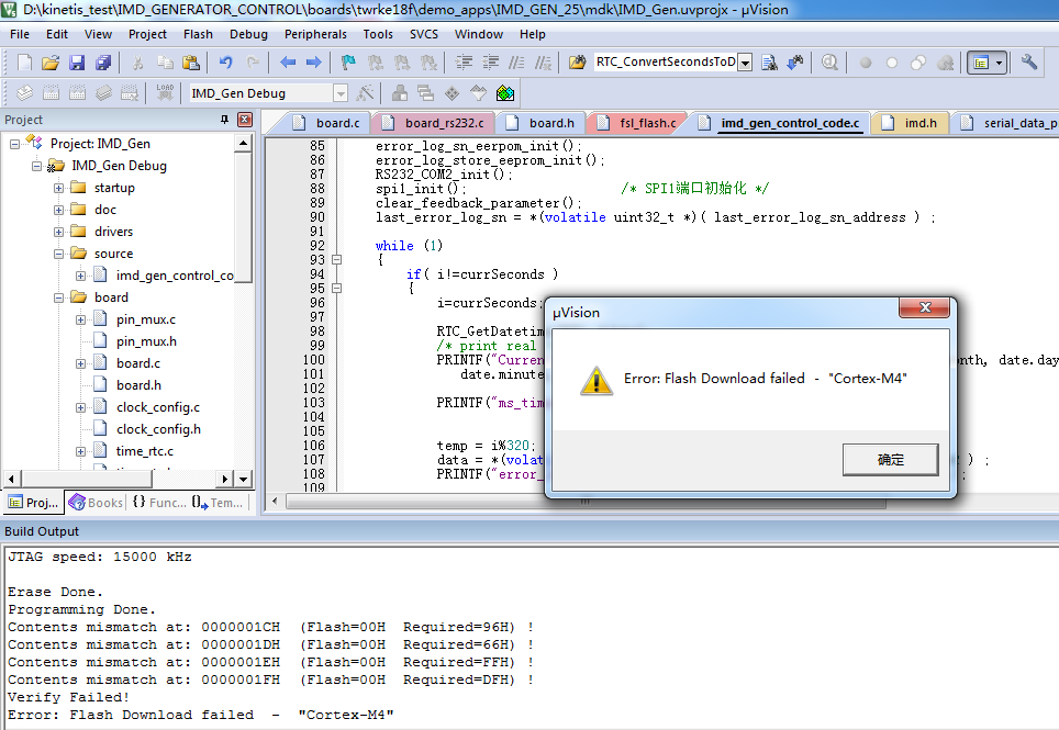

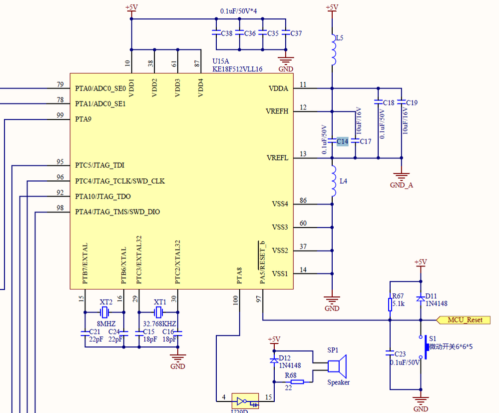

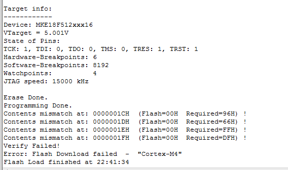

mdk 5.14,  KE18F512VLL16, JLINK,  flash download failed.

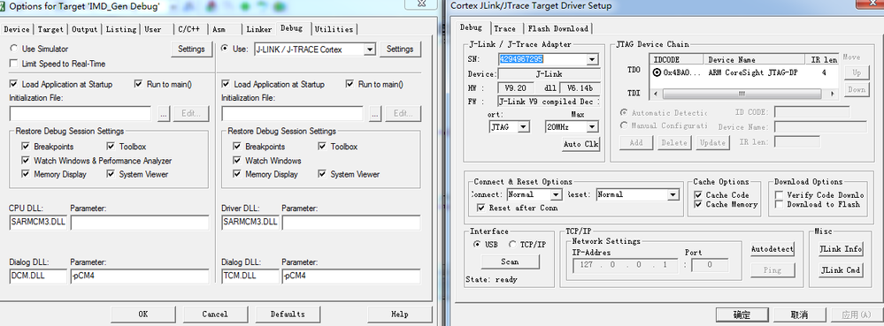

my power and reset circuit
JLINK SET
Why?

   MKE18 is the new chip, maybe your JLINK can't support it, especially if it is not the official version.
   I think you can update your JLINK driver to the newest one from:
www.segger.com
  Then use the JLINK commander, check whether you can find the KE18 board, and whether you can use the jlink commander: loadfile filename.bin
to download the code successfully?

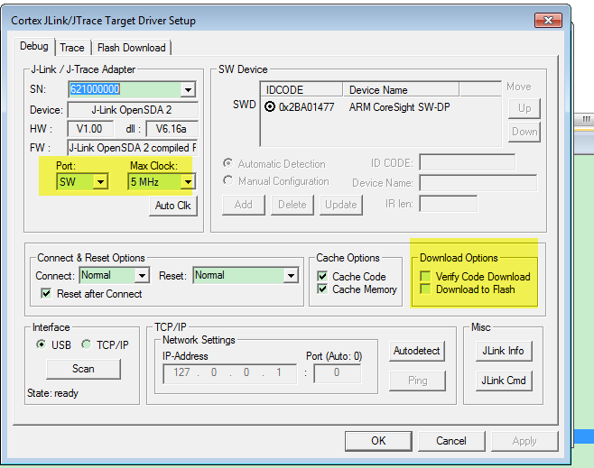

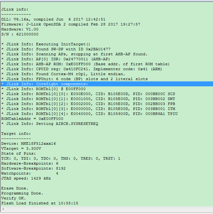

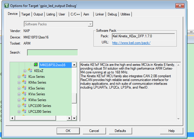

    I also test my TWR-KE18F with the KSDK2.2 MDK project.
   This is my test result:

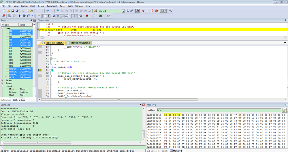

From your picture, it seems your problem is caused by the flash address 0x1c, 0x1d,0x1e,0x1f. Your content is 0X00, my I have check my these address data, it is also 0X00.
 So, I think you can try the SWD method, and don't select the verify code download like me again.

lifeng
Hello Kerry Zhou:
     The tools is Jlink V9 from taobao,  I think whether it can't support MKE18F512VLL16  well.
      I can't find the JLINK OPENSDA V2 that you used tools in NXP web, Where to buy the JLINK OPENSDA V2 ?
