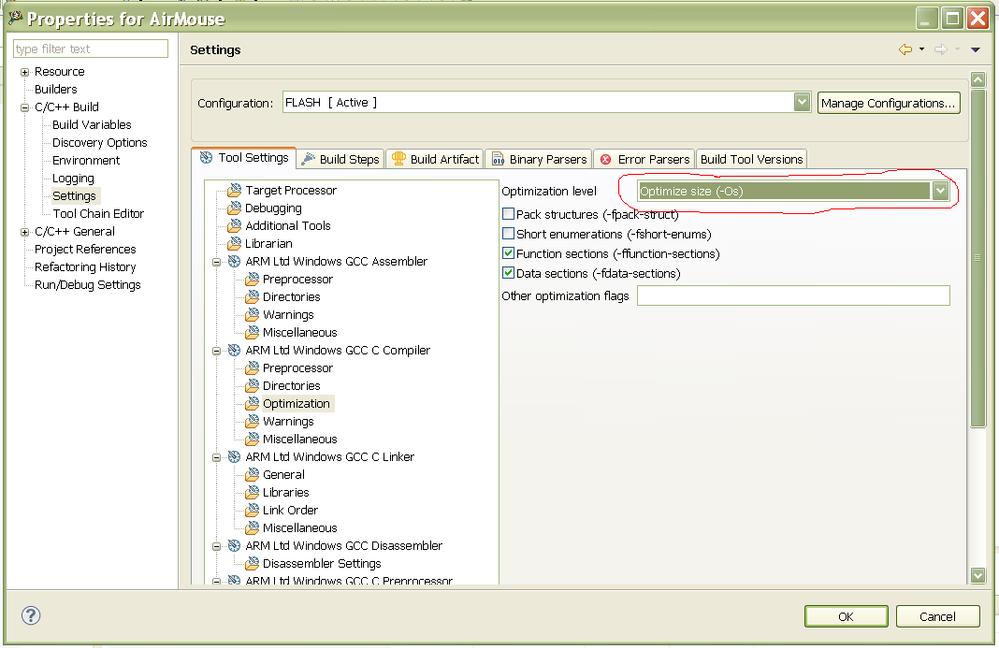

xiaodong_zhang
hi karuvat,
    Please make sure optimization level chosen by you is optimize size(-Os).
1,831 Views
Hui_Ma
Please check your project compile generated map file about memory usage.
I suggest to use CodeWarrior GCC compiler, which has higher compile performance for Kinetis product.
Wish it helps.
Ma Hui
