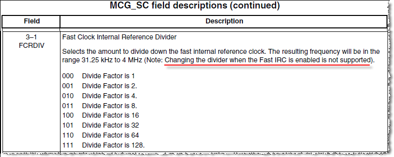

1. I am setting the MGC_SC and the SIM_DIV registers before entering VLPR. I actually set up the MGC_SC register in the FEI state. Does the FCRDIV setting have any effect while in in any other mode such as RUN as long as the internal fast clock is not enabled?
2. Does this setting of FCRDIV look correct? I am setting this in the FEI state.
// Set FCRDIV to 0 so that when the internal fast clock is used it will not
// be divided down. This will allow us to get to the max frequency of the
// 4 Mhz fast clock.
unsigned char tempRegister = MCG_SC;
tempRegister &= ~(MCG_SC_FCRDIV_MASK);
tempRegister |= MCG_SC_FCRDIV(0);
MCG_SC = tempRegister;

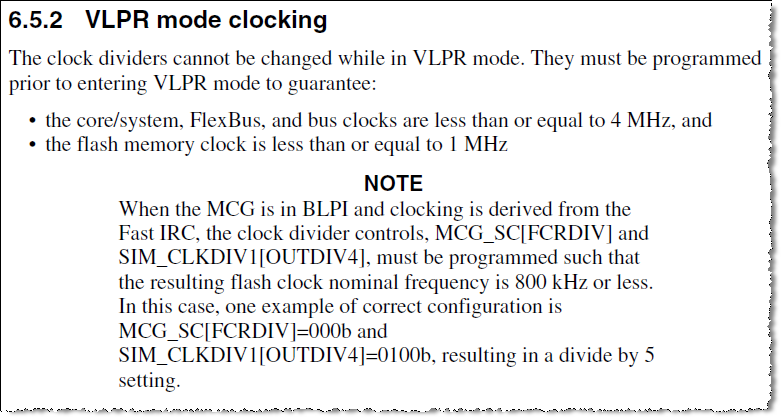

3. I am setting the dividers just before entering VLPR mode. MSGCLKOUT should be at 4 Mhz because of the setting of FCRDIV. Does this look correct?
// The MSGCLKOUT is then divided by SIMDIV of 0, 0, 0, 7.
// 0 = divide by 1
// 7 = divide by 8
// Thus, the following rates apply in this situation:
// Core/System = 4Mhz
// Bus = 4Mhz
// Flexbus = 4Mhz
// Flash = 500Khz // Cannot go over 800 due to security processor errata
// see section 6.5.2 VLPR mode clocking in reference manual
SetSysDividers2( 0, 0, 0, 7 );

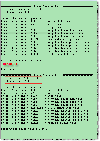

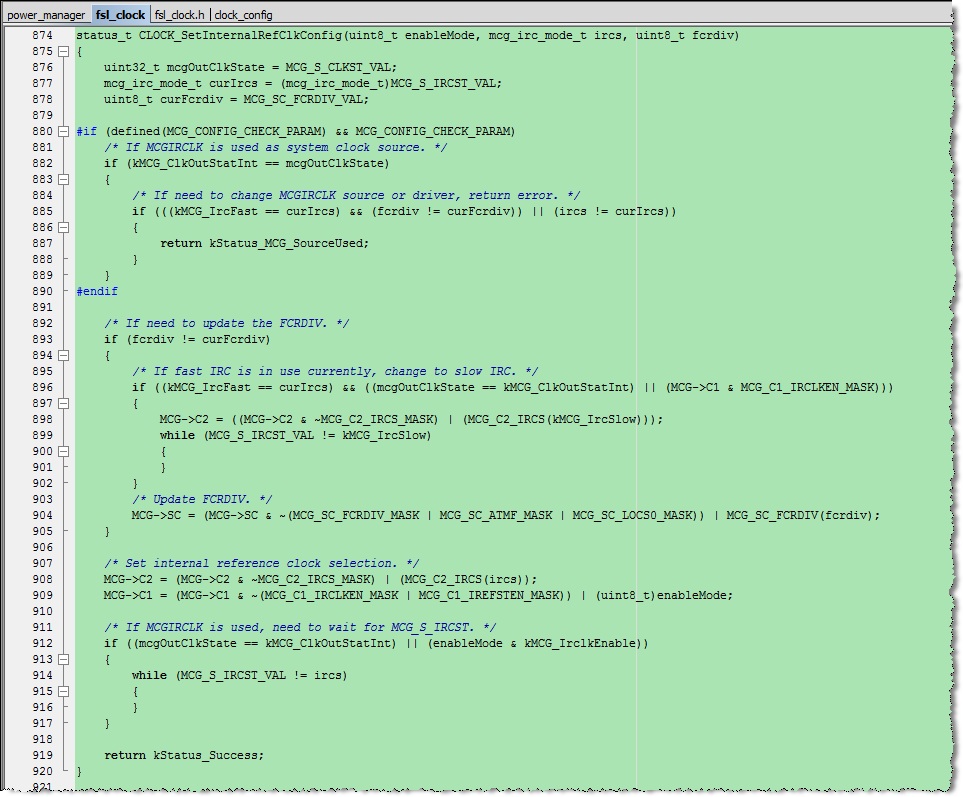

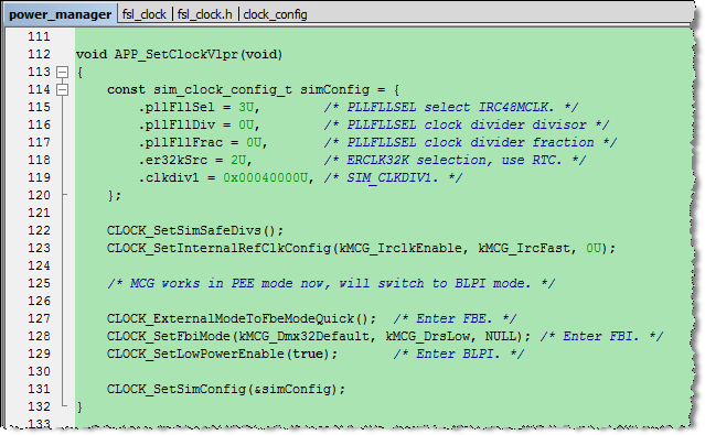

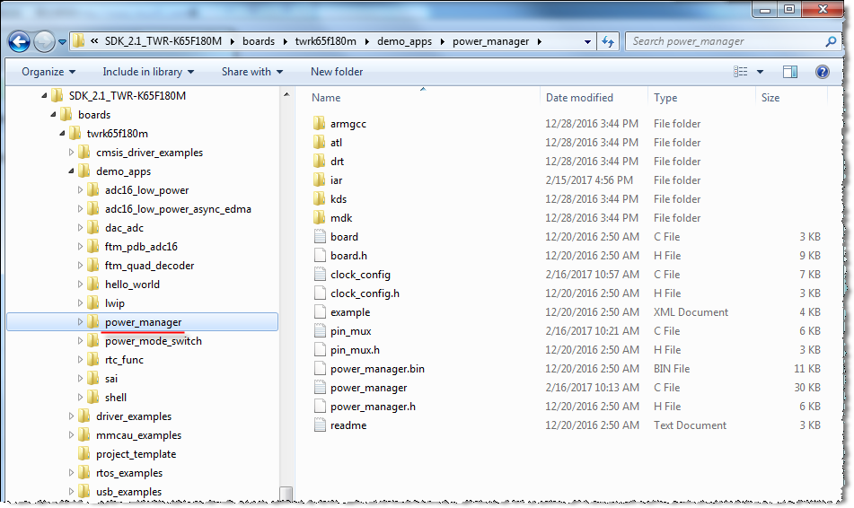

Robin_Shen
Hi Chris,
Have you try to test the power_manager demo in SDK_2.1_TWR-K65F180M.
After input D , the MCU will enter VLPR. And you will get the Core Clock = 4MHz.

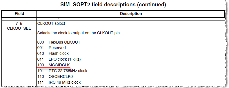

You can observe the 4MHz MCGIRCLK on CLKOUT pin(PTC3):
1. Open the Clock Gate of PORTC.  CLOCK_EnableClock(kCLOCK_PortC);
2. Select the Pin Mux of PORTC3 to Alternative 5 as CLKOUT function. PORT_SetPinMux(PORTC, 3u, kPORT_MuxAlt5);
3. Select the MCGIRCLK to output on the CLKOUT pin. CLOCK_SetClkOutClock(0x04);
See also below information.(It seems that you have already notice these informations.)
