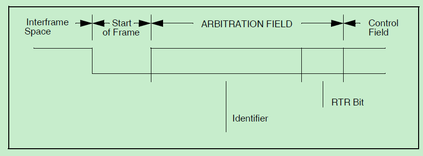

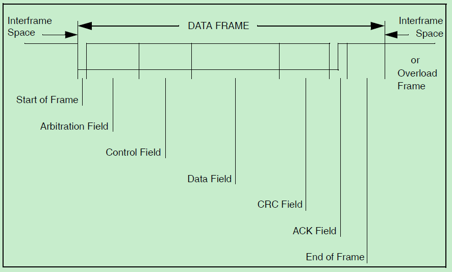

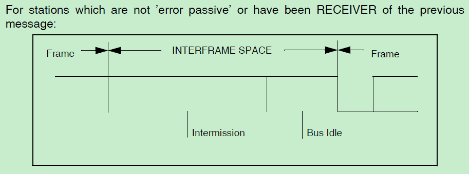

From the CAN spec (CAN baud rate 1Mbps), there with below time interval between the two CAN frames interval:
[ACK Delimiter]     1us
[End of Frame]      7us
[CAN1_SendFrame() function execute time]       9us
[INTERFRAME SPACE]'s [Intermission]        3us
[INTERFRAME SPACE]'s [Bus IDLE]            1us
Total interval value added is 21us.
The actual interval between two CAN frame is 25ms, not 21us as expected.
I checked this issue with Kinetis product team with below feedback.
The TASD field will affect start of arbitration delay among TX message buffers (internal arbitration). The next message to be transmitted must be configured before CRC field to participate of arbitration process. Otherwise, the arbitration will start again in BusIdle.
So to optimize the transmit delay, new Tx MB must be configured before CRC field in the current transmission/reception. If the Tx Message is configured after IFLAG set from current transmission/reception, the next internal arbitration to select a Tx winner will happen in BusIdle.
