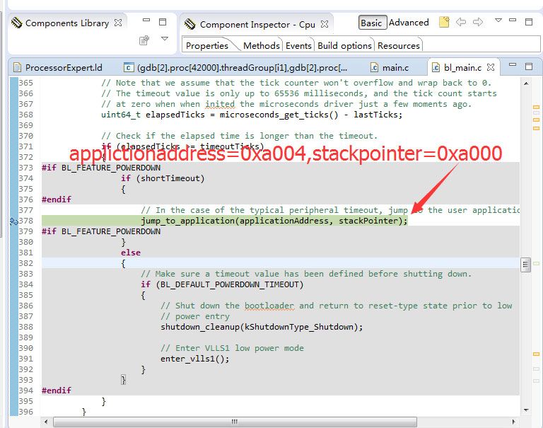

donot from Kinetis Bootloader V2.0 jump to my application with MK22FN512
2,140 Views
andypeng

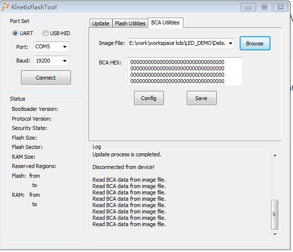

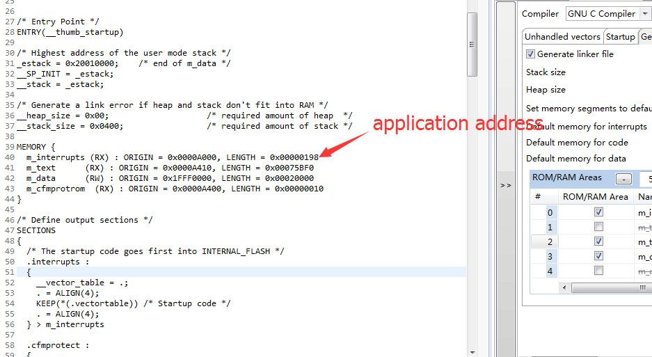

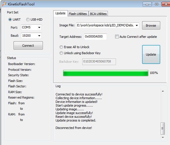

I am using freedom_bootloader of Kinetis Bootloader V2.0, application update MK22FN512, using serial connection communication, KinetisFlashTool has been written to the end. But then did not jump into my application.166682_166682.jpgupdate1.jpg

After testing, you should use the Release version of the freedom_bootloader demo instead the Debug version.
Then the jump execution can go well.
