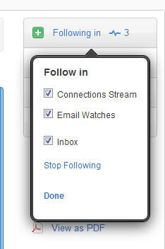

jeremyzhou
Hi Davidsun,
Thanks for your reply, In my opinion, I think that the MCU will always repeat boot sequence while the Reset pin is kept low even MCU hasn't been programed.
So it's normal to consume some power. You can click the icon 【Following in】 and just select all, then you will get an email immediately when there's new reply happen!
Hope this reply help.
Ping
