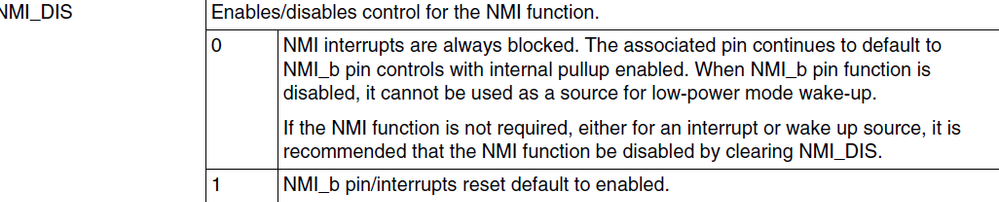

I am concerned about unwanted NMIs.  If I do not enable the NMI pin functionality, will this suffice to ensure that I will not get any NMIs or do I have to explicitly set the NMI_DIS bit of the FTFE_FOPT register?

Actually the manual mentioned this already:
it is recommended that the NMI function be disabled by clearing NMI_DIS (NMI_DIS bit of the FTFE_FOPT).
