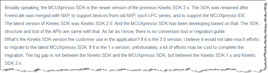

Here is the related information that customer may not be able to access.

Hi John,
unfortunately it is not possible to import SDK 1.x project as an SDK 2.x project. There are significant differences between Kinetis SDK 1.x and MCUXpresso SDK 2.x (previously known as Kinetis SDK 2.x) and there is not any conversion tool.
Some other related information can be found here:
https://community.nxp.com/message/1071715?commentID=1071715#comment-1071715
