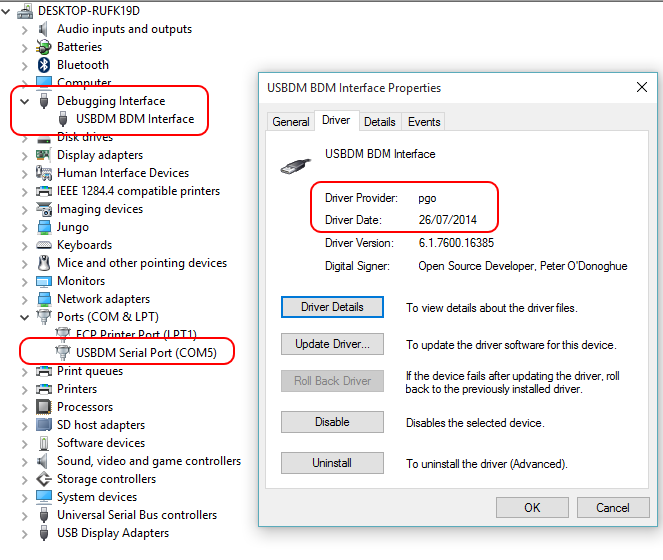

I tested a FRDM-KL25Z with the following:
  • USBDM Driver USBDM_Drivers_4_12_1_Win_x64.msi
  • USBDM Firmware from USBDM Software USBDM_Drivers_4_12_1_Win_x64.msi
It installed fine and the BDM was correctly detected under Windows 10.  I have also used with Windows 8.
Can you provide more information on your system and check the version against the above?
The screen grab below show the detected BDM with the BDM interface and CDC(serial) interface.
bye

ronakpanchal
Fresh Out Contributor
Hi Pgo,
Thanks for your reply.
I managed to install drvier and now my Device is detected as a USBDM interface, but not as a serial port.
I had programmed KL26Z board using ARM Programmer(utility available with USBDM) from KL25Z through SWD connection and working properly.
But i require to Debug the code, so i have gone through the steps for debugging using USBDM but i got error.
Can you please Provide your inputs ?
I am using the 4_12(latest version) of USBDM.
Also please share the steps for to debug using it in KDS for latest version.
Ronak Panchal

pgo
Senior Contributor V
Hi Ronak,
Are you sure that you are using the latest version of firmware and drivers as described above?
When I signed the drivers there were some required changes in the drivers and the firmware that makes it very important that matching software and firmware are used.
Using the wrong drivers may result in the serial port not being present.
In any case the serial port can't be used with an external target as the required connections (Tx & Rx) and not present on the ARM debug connector.  It is only really intended for the on-board chip.
It is still possible to use semi-hosting with with printf()s when debugging an external target.
USBDM: Setting Up the FRDM-XXXX
bye
