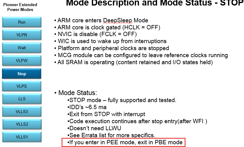

    Please check this picture at first:
Take care, if you are using PEE mode, after exit the STOP, the clock mode is PBE, so your clock is changed, you need to change PBE to PEE again to keep the same clock frequency.
Wish it helps you!

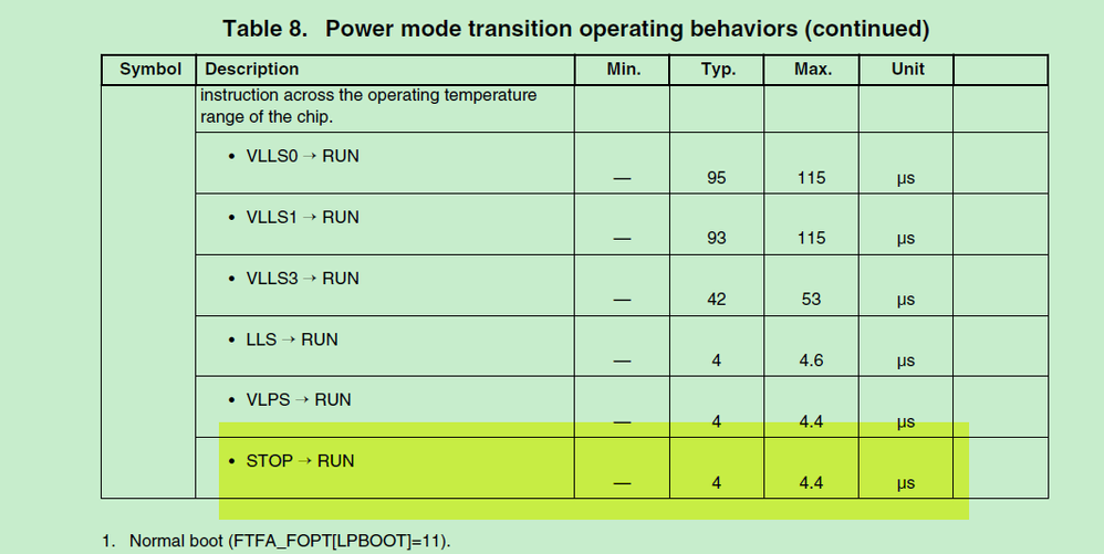

now code execution speed is ok, but it takes surprisingly long time to start, 80us. That is the time between TMP module interrupt trigger (can be seen from pwm signal and cpu current consumption)  to isr to run. Is wake-up from STOP mode really so slow?
4,779 Views
kerryzhou
Hi tuomas aaltio,
   STOP to RUN wake up is normally 4us, but if you do the clock mode switch, then run the TPM again, the clock mode switch also need to cause time, but this time is not the wake up time.
