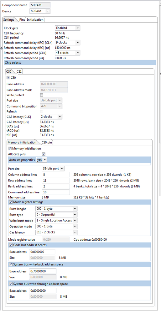

I'm trying to use the external SDRAM on the TWR-K65 board.
Setup was done with processor expert but unfortunately, I have no idea if these values are correct.
Can anyone make a statement if these values make sense?

I'm trying to use Processor Expert to get my SDRAM running.
Can you check if I'm doing anything wrong ?

Hello Peter,
It seems that you have incorrect settings of SDRAM timing. I can see the refresh period on your screenshot only but there can be also another parameters set incorrectly. You can see the datasheet of the SDRAM silicon that is available on the TWR-K65F180M target board (see for example page Micron Technology, Inc. - MT48LC2M32B2P-5).
I have created a simple demo application (with Init_SDRAM component) that works properly on the TWR-K65F180M target board, see the attached archive. There is writing into SDRAM memory and reading/checking of the SDRAM memory content.

edit:
the breakpoint is triggered because the FelxBus pin muxing is not correctly done in the sdram pin init as i desribed in this post Init of FlexBus pins in SDRAM mode . Once you fix this, the test suceeds successfully. at lest for the sequence provided by your example
