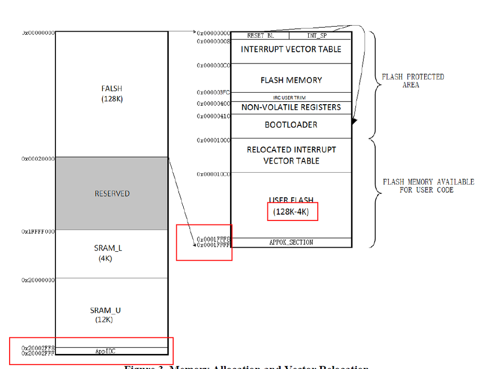

and other about flash need to be change , please refer to this picture to check whether is right :

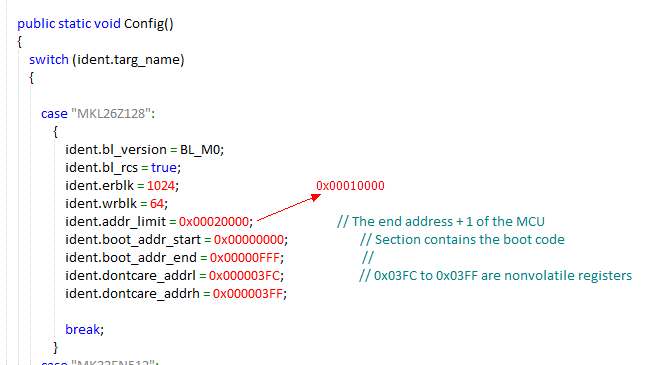

- The other part is the GUI code : mainly change the file of ""GlobalVars.cs" ,
you need refer to the "MKL26128" to add other part as it :
You can first change the places i mentioned above , then test , if it sitll can not work , you can tell me the detail information or

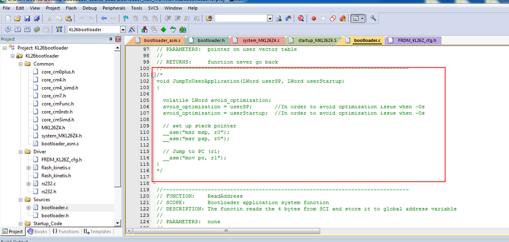

Function ::
void JumpToUserApplication(LWord userSP, LWord userStartup)
  volatile LWord avoid_optimization;
  avoid_optimization = userSP;       //In order to avoid optimization issue when -Os
  avoid_optimization = userStartup;  //In order to avoid optimization issue when -Os
  // set up stack pointer
  __asm("msr msp, r0");
  __asm("msr psp, r0");
  // Jump to PC (r1)
  __asm("mov pc, r1");
is showing error ,,,,,,,,,,......

Hello Joy,
In the KEIL ,  the define of the function "JumpToUserApplication" is in the "bootloader_asm.s" file ,
The function you mentioned have been shield in KEIL IDE :
And the whole version  and the lasted version of the project you download here :
jenniezhjun/Kinetis-Bootloader · GitHub
Hope it helps
Alice
