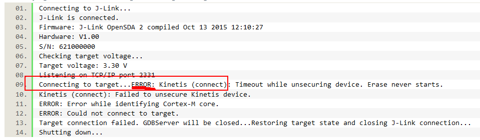

when trying to unlock from KDE I get following message in the console
Connecting to J-Link...
J-Link is connected.
Firmware: J-Link OpenSDA 2 compiled Oct 13 2015 12:10:27
Hardware: V1.00
S/N: 621000000
Checking target voltage...
Target voltage: 3.30 V
Listening on TCP/IP port 2331
Connecting to target...ERROR: Kinetis (connect): Timeout while unsecuring device. Erase never starts.
Kinetis (connect): Failed to unsecure Kinetis device.
ERROR: Error while identifying Cortex-M core.
ERROR: Could not connect to target.
Target connection failed. GDBServer will be closed...Restoring target state and closing J-Link connection...
Shutting down...
Have I somehow bricked the board, or am I missing something to fix this?

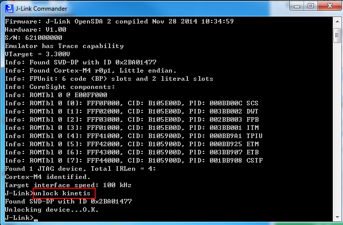

If you want erase the chip , you can entry "unlock kinetis" on the J-Link Commander :

frederiknielsen
I already had the Jlink bootloader, but installed the one you linked to anyway..
Correct it seems to not connect now, but I have been able to connect and program this board before.

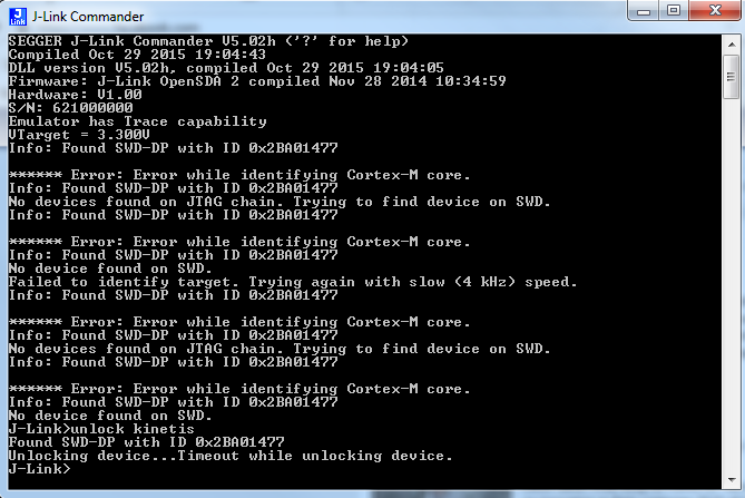

Anyway, here is a screen of trying the "unlock kinetis" feature in Commander.
The reason I still assume I have connection to the MCU, is that I can get results from the MDM-AP status register
The change in readout is because the watchdog is resetting the MCU with 71kHz
2,667 Views
Hello ,
I think your chip has disalbe mess erase function , so it can not erase or write now.
