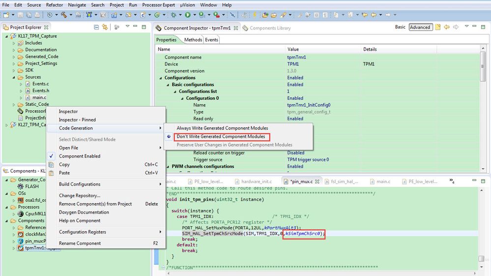

    Now, when you use the KL17, after you finished the configuration of fsl_tpm module, you can modify the init_tpm_pins code,:
    change SIM_HAL_SetTpmChSrcMode(SIM,TPM1_IDX,0,kSimTpmChSrc2);
  to
  SIM_HAL_SetTpmChSrcMode(SIM,TPM1_IDX,0,kSimTpmChSrc0);
    Then lock the TPM module like this:
   Then your modified code will not be updated.
   Wish it helps you!

At the moment, we put an extra SIM_HAL_SetTpmChSrcMode(SIM,TPM1_IDX,0,kSimTpmChSrc0) in user code right after the HW initialization. We don't like to have to put any "Generated_Code" under version control. I'll rather wait for updated generator.
2,980 Views
kerryzhou
Of course, if you don't want to modify it, you just can solve it by calling SIM_HAL_SetTpmChSrcMode(SIM,TPM1_IDX,0,kSimTpmChSrc0) in your main function.
  It has the same results.
