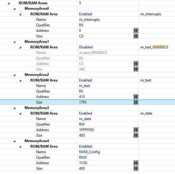

Here is how my memory configured in the Processor Expert:

I have done a little research on this subject and when I was trying to change the linker file, I have noticed that it is maintained by Processor Expert. I am trying to write my routines for writing to flash and erasing it. I am only using "Init_FTMR" component to initialize it.
I have found AN4497 and also some other threads on this forum but their pragma directives doesn't work and also linker file is altered all the time by processor expert.
I have also found out this tutorial. Quoted from this tutorial is below. I didn't understand where I will right click and do the instructions he mentioned.
This is achieved by placing the code to execute the flash commands into the on-board RAM for execution. To do this you need to right-hand click on the file you are using to write data to flash, and selecting options.  You then need to look at the memory assignment section at the bottom of the page and change the ‘Code / Const’ to a RAM region on your MCU. This will ensure that every time your application starts this section of code is copied into the RAM for execution.
Do you have any idea how can I put a function to RAM when I am using Processor Expert?

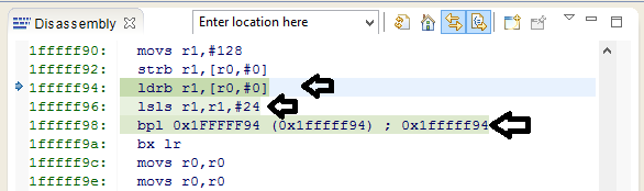

In the debugger, it loops between these marked lines:
8,855 Views
mjbcswitzerland
Specialist V
Hi Abdullah
You are calling the routine incorrectly for the KE devices
fnRAM_code((volatile unsigned char *) FTFL_BLOCK); will work for for K and KL devices because the status register is the first entry and so is equal to the block address.
For the KE family you can use
fnRAM_code((volatile unsigned char *) FLASH_STATUS_REGISTER);
where FLASH_STATUS_REGISTER is either (FTFL_BLOCK + 5) or directly
#define FLASH_STATUS_REGISTER    0x40020005                // Flash Memory Module  Status Register Address
Mark
8,854 Views
abdullahkahrama
YAY! Thank you very much, it worked :smileyhappy:
