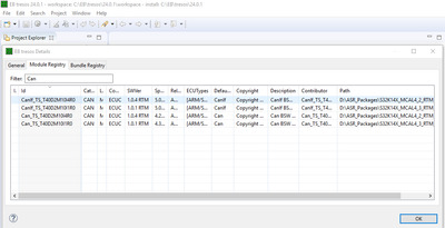

      I have a  S32K MCAL project base on S32K14X_MCAL4_2_RTM_1_0_1. when I import and open the project in EB  tresos, EB push error:
    Plug-in with a module "Can_TS_T40D2M10I1R0" is not installed - cannot create module configurations for project "S32K146_4.2_RTM1.0.1"
    Unfortunately, the installation package  cannot be found on the NXP official website. How do I get it?

Please open your EB tresos, choose Help - EB Tresos Detail. In Bundle Registry tab, check whether the Can package was installed successfully and the path of it.

Without packages in the window. Because I don't have  “S32K14X_MCAL4_2_RTM_1_0_1.exe”  installation package.
I already have installation packages for V1.0.0 and V1.0.4, but are lack of V1.0.1, and this is exactly what I want.

Your request has been processed. Please check in your Software Licensing and Support, AUTOSAR MCAL product and find in the Previous tab.

Wow! Nam, thank you very much! I get it.
