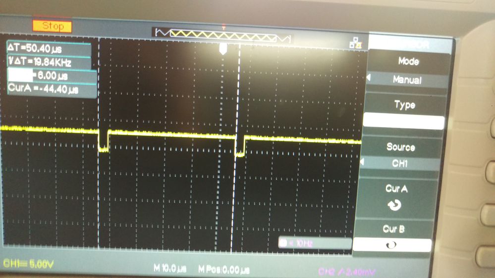

I have a FRDM-MC-LVBLDC driver and I'm using it with FRDM KV-11z. I wanted to observe my pwm waveforms on Phase A,B and C output ports before I provide it as the input to my motor. The reason behind it is because I tried measuring them with the motor being connected and my BLDC driver MOSFET was damaged due to some issue. I didn't wanted to take risk this time so I using an oscilloscope first to check what type of waveform I'm getting first.
When I observe the waveform on the oscilloscope, the PWM frequency is accurate but the duty cycle is showing as 95% ON time. I'm using the basic SDK example "mc_bldc" , which has a duty cycle of 50% and no matter now many changes I do by changing the value of "FTM0->CONTROLS[0].CnV"  , "FTM0->CONTROLS[1].CnV" and so on , it just doesn't change the duty cycle of the waveform.
So I wanted to know if it's possible to observe the waveforms or it's mandatory to connect it with a Motor to observe my waveforms.  Any kind of guidance will be helpful

sidi
Hi Keyy Zhou,
Thank you for the help, but I am using the "frdmkv11z_mc_bldc" example. I am able to see the PWM waveform when I'm using the "ftm_simple_pwm" example and the "ftm_pwm_twochannel", no issues in that.
The problem comes when I use the "mc_bldc" example from the demo_apps folder.
In that example it is using 6 channels which are - C1,C2,C3,C4,D4 and D5.

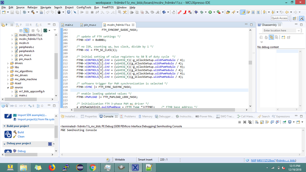

And the dutycycle is set in the "InitFTM0()" funtion as shown below.
I am not making ANY CHANGES in the duty cycle. Im using this "mc_bldc" example just as it is , with out any changes made.
So the example code sets 50% as duty cycle. But when I connect the MC-LV-BLDC Driver shield with the FRDM Kv11z and Power Up driver using 12V power source. I'm not getting the waveform on my channels with 50% duty cycle.
This is the waveform observed on Pin C1. Other channels show similar duty cycle (C2,C3,C4, D4 and D5) .The duty-cycle is around 95%.
I think I'm missing some minute detail here. Like on which pin to measure my PWM signal. I tried measuring the PWM waveform from the Output ports of BLDC driver as well, which is PHA , PHB and PHC ports which are Phase A , Phase B and Phase C output ports of my MC-LVBLDC driver.
Thank you

muduhuweh
Hey Kerry,
The value in FTM register is 262.
To be precise I am setting the FTM->CONTROLS[0].CnV register.
Yes it is 50% because the register is set as given below :
/* initial value of the FTM counter */
FTM0->CNTIN = (uint32_t)(-(g_sClockSetup.ui16PwmModulo) / 2);
/* modulo value */
FTM0->MOD = (uint32_t)((g_sClockSetup.ui16PwmModulo / 2) - 1);
/* Initial setting of value registers to 50 % of duty cycle */
FTM0->CONTROLS[0].CnV = (uint32_t)(-g_sClockSetup.ui16PwmModulo / 4);
FTM0->CONTROLS[1].CnV = (uint32_t)(g_sClockSetup.ui16PwmModulo / 4);
FTM0->CONTROLS[2].CnV = (uint32_t)(-g_sClockSetup.ui16PwmModulo / 4);
FTM0->CONTROLS[3].CnV = (uint32_t)(g_sClockSetup.ui16PwmModulo / 4);
FTM0->CONTROLS[4].CnV = (uint32_t)(-g_sClockSetup.ui16PwmModulo / 4);
FTM0->CONTROLS[5].CnV = (uint32_t)(g_sClockSetup.ui16PwmModulo / 4);
Where :
g_sClockSetup.ui16PwmModulo = 1048
I am just using the sdk demo example without any changes. So I'm getting all my values from the sdk.
