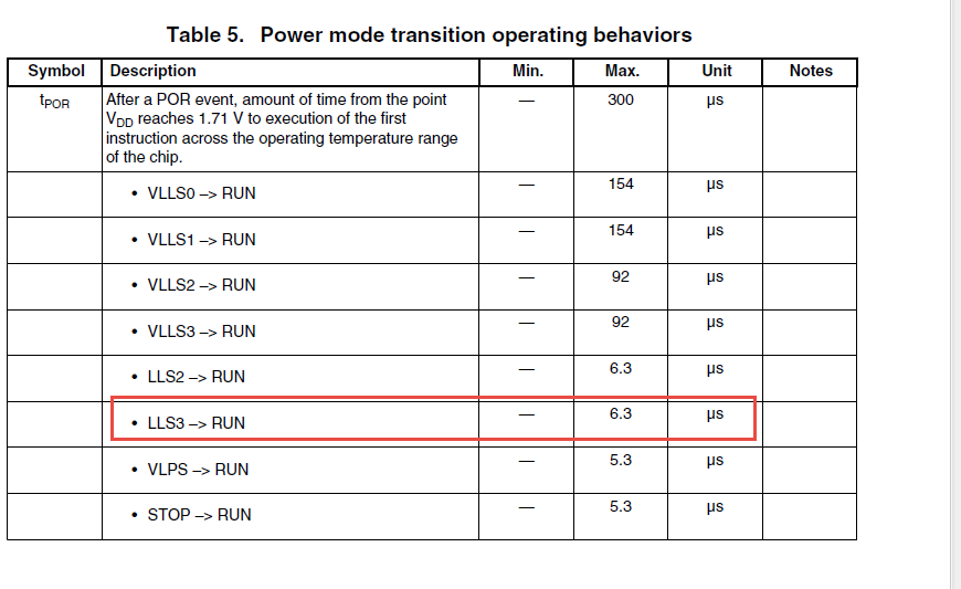

So in our case duration of start bit 8.3us is comparable with wakeup time 6.3us and basically first start is not detected.
I just wondering how to I2C can work in similar mode ? Clock there 400Mhz what is even higher.
Or I2C slave peripheral is always "ON" and can detect own address even on LLS3 mode and LLWU pin no need at all.
Eugene

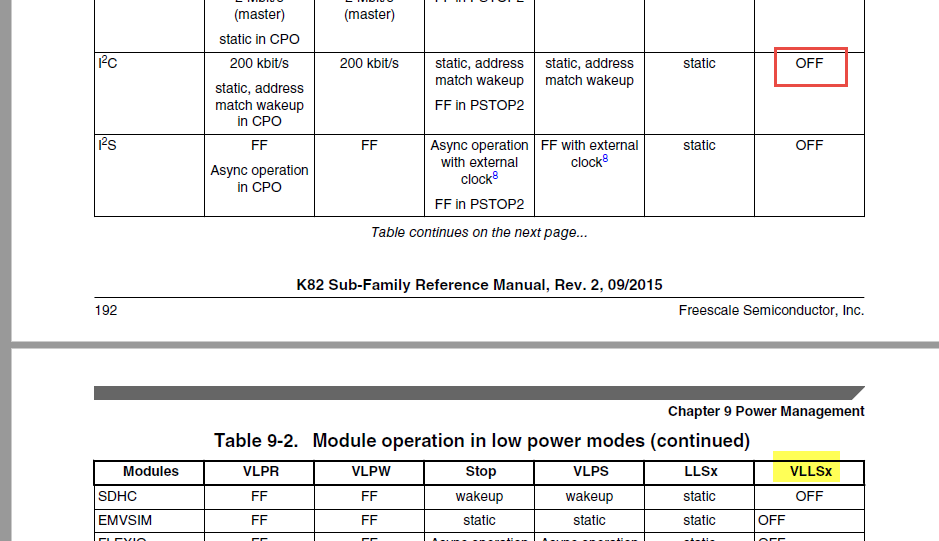

   What I mean is the first edge will be detected as the LLWU wake up signal, not the I2C start signal, just after the MCU has really waked up, then it's I2C module can work normally, that's why you will lost the first byte.
    So, I think from your master side, you can try another start signal again.
    VLLSX mode can't use the I2C address match to wake up the mcu:
Wis it helps you!
