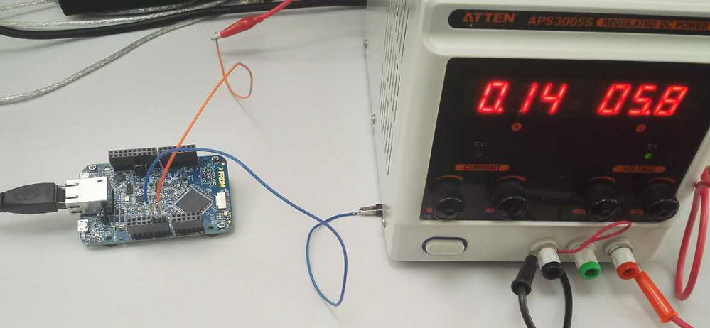

Hui_Ma
I also do a same test add 5.9V power to J3-16 pin, the FRDM-K64F J25 need short 2-3 as below picture shows:
After that, the board should works as expected.
Wish it helps.
Ma Hui

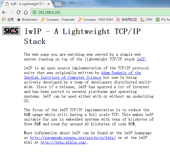

Hui_Ma
I do a lwip http server test based on KSDK V2.0 demo, and I could visit the HTTP server as below picture shows:
I would recommend customer try with the KSDK V2.0 demo for FRDM-K64F board, the related software could be downloaded from here.
Wish it helps.
