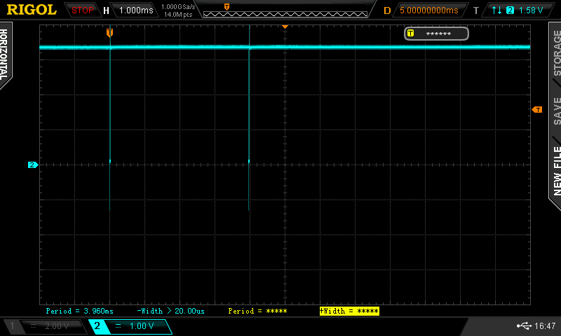

Hello everybody!
I am trying to periodically trigger the FTM using the PDB. The problem is that the FTM is only triggered once, not periodically, as suggested by this oscilloscope screenshot:SignalScreenshot.png
I have configured the FTM interrupt to stop the FTM after a pulse and then re-initialise it, so that it will produce another pulse when triggered by a sync signal. The first pulse in the image is caused by the initialisation of the FTM, and the second pulse is caused by the PDB triggering the FTM.
Afterwards, the PDB just simply doesn't seem to trigger the FTM anymore.

I am sorry for the late reply, but in the meantime I managed to find out what caused the problem. I will document the solution here for future reference.
I had the HWTRIGMODE bit of the SYNCONF register set 0, so that the FTM would clear the hardware trigger settings every time it was triggered. After the first pulse the FTM generated, it erased the hardware trigger settings, so that it could never be triggered again, hence why I only got a single pulse.
Setting the bit using:
FTM0->SYNCONF |= 1;
solved my issue.

Could you explain how you set the FTM trigger? it was made in the interrupt?.
Also are you triggering your PDB with PIT Ch 0 Output? PDB_GetDefaultConfig function set pdbConfigStruct.enableContinuousMode = false;  So it is configured in One-Shot mode, if you want your PDB operates in continues mode you need to set this option in true.
