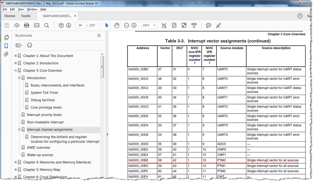

Hi Samer,
Sorry for the inconvenience! This section may lack the NVIC setting of FTM0.
Please refer the method descripted in '3.1.2.1 Configuring the NVIC' of KQRUG.
Robin

Thank you for your response. Actually I tried adding this before asking the question:
    NVIC_ENABLE_IRQ(IRQ_FTM0);
But it didn't help. Would it be asking too much to provide a minimal working example?

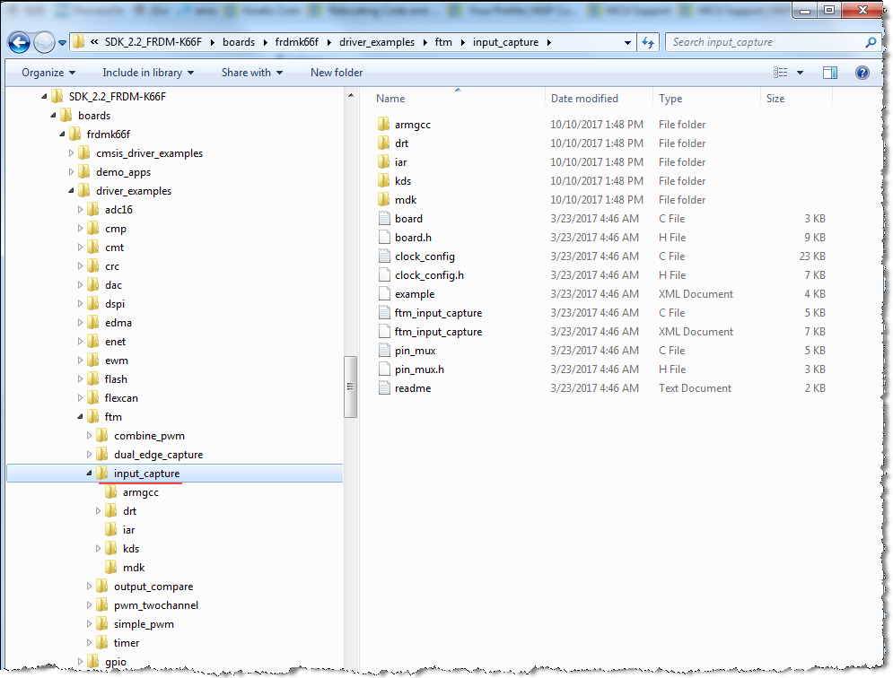

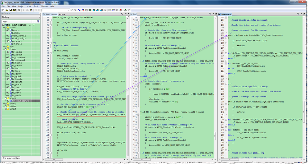

Please download the SDK_2.2_FRDM-K66Fpackage refer Generating a downloadable MCUXpresso SDK v.2 package.
And then you can find the input_capture example in it's folder. (For example: C:\SDK_2.2_FRDM-K66F\boards\frdmk66f\driver_examples\ftm\input_capture)
Robin
