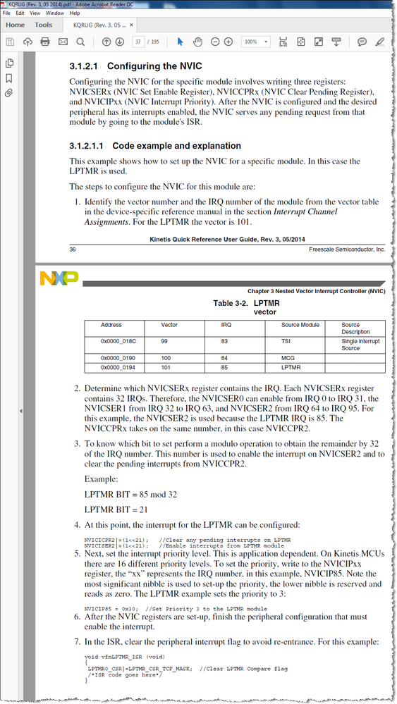

Hi Samer,
Sorry for the inconvenience! This section may lack the NVIC setting of FTM0.
Please refer the method descripted in '3.1.2.1 Configuring the NVIC' of KQRUG.
Robin
