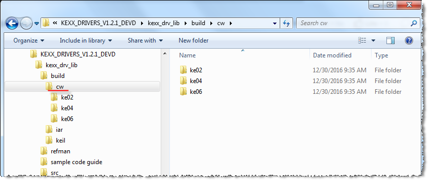

For the KE02\04\06 we recommand to use KEXX_DRIVERS_V1.2.1_DEVD. Because the KE02\04\06 is not on the support list of KSDK1.3 and KSDK2.0(MCUXpresso-SDK).
There are cw(CodeWarrior10.x) projects in KEXX_DRIVERS_V1.2.1_DEVD too. You can test these projects.

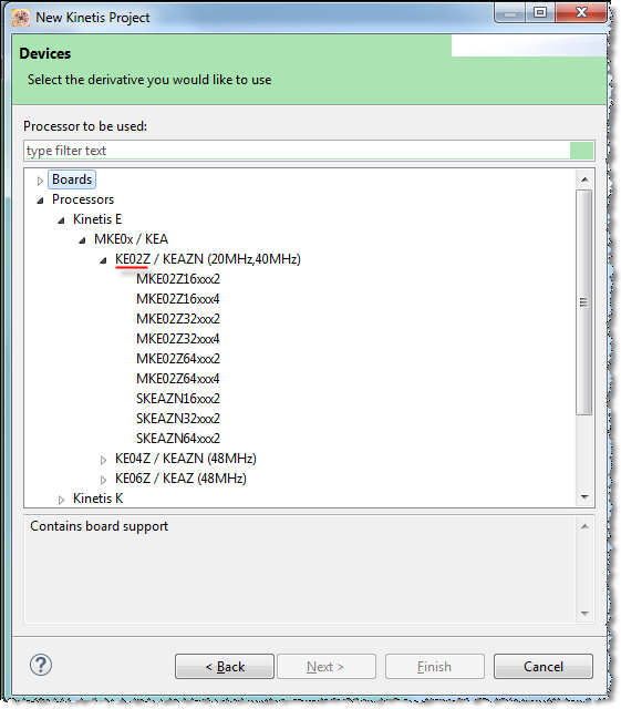

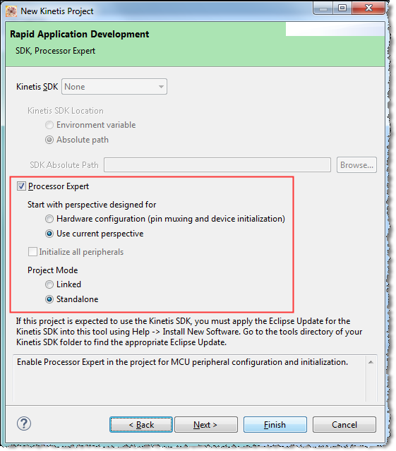

You can use KDS3.2 or CodeWarrior10.6 to generate Processor Expert project of KE0x.
See below attach method:

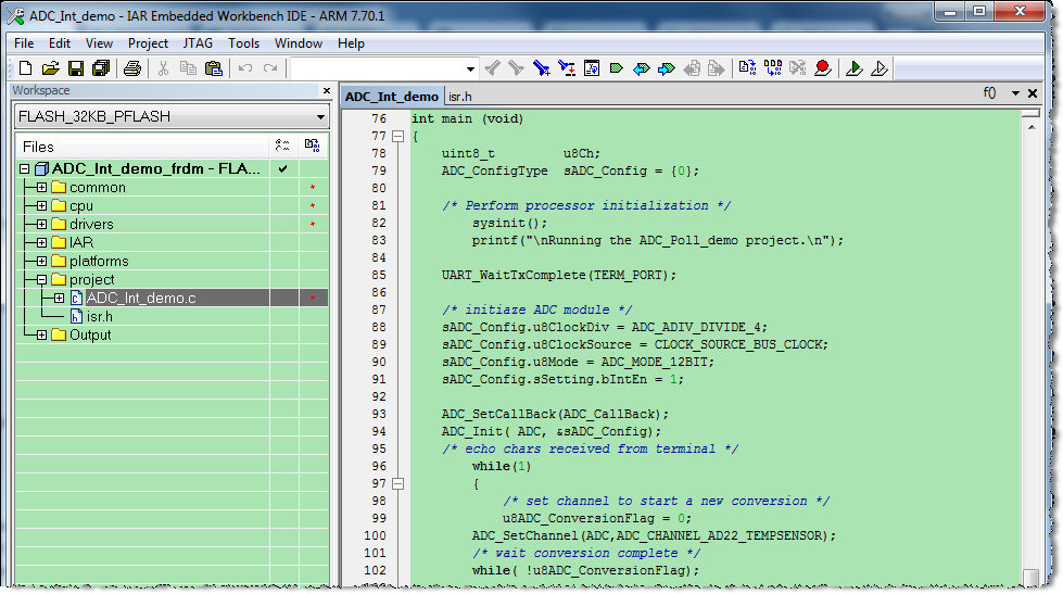

Have you try to use the ADC_Int_demo in KEXX_DRIVERS_V1.2.1_DEVD.
Or you can attached your project here, so that we can help you easier.
Robin

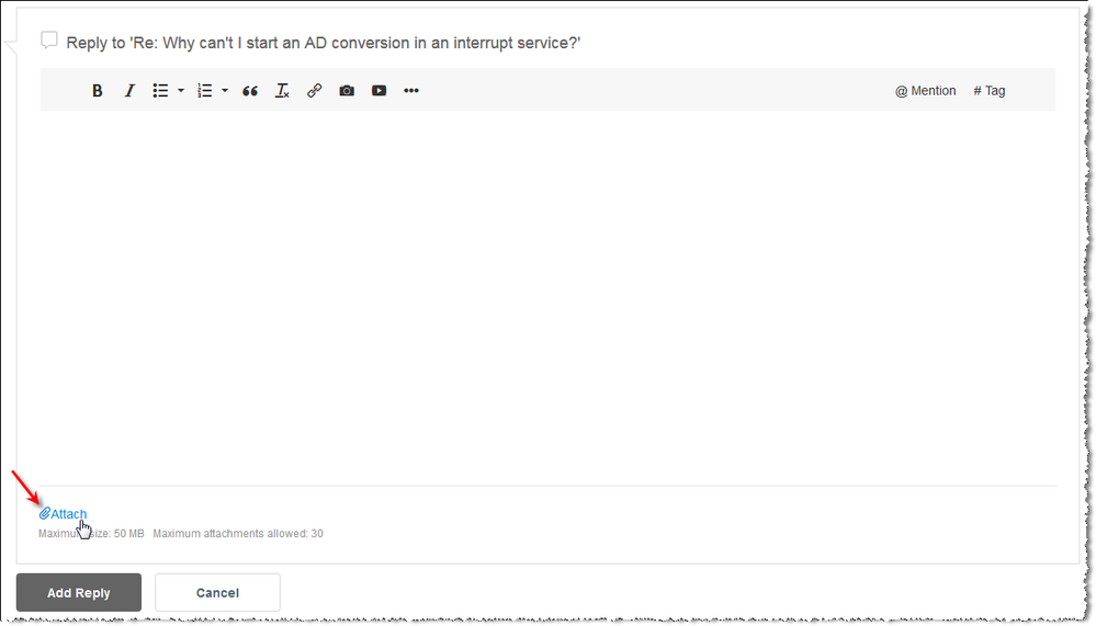

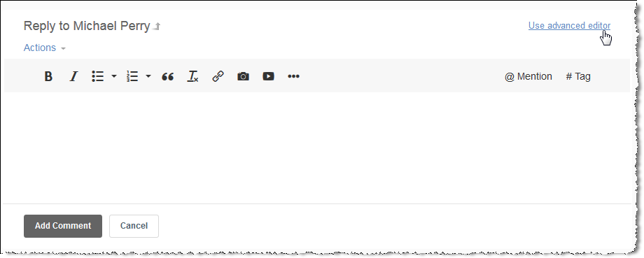

Still puzzled by attachments...    When I hit "reply" at the bottom of your post "  I see "reply to robin_shen" and right below it is a gray bar that says:
B  I  (and more things I can't type)
there is no blue "use advanced editor", no blue "actions", and no blue "Attach" at the bottom of the window.  the buttons are "post" and "cancel", no "add comment" or "add reply"
This is not so important now, but I may want to upload a file someday.
