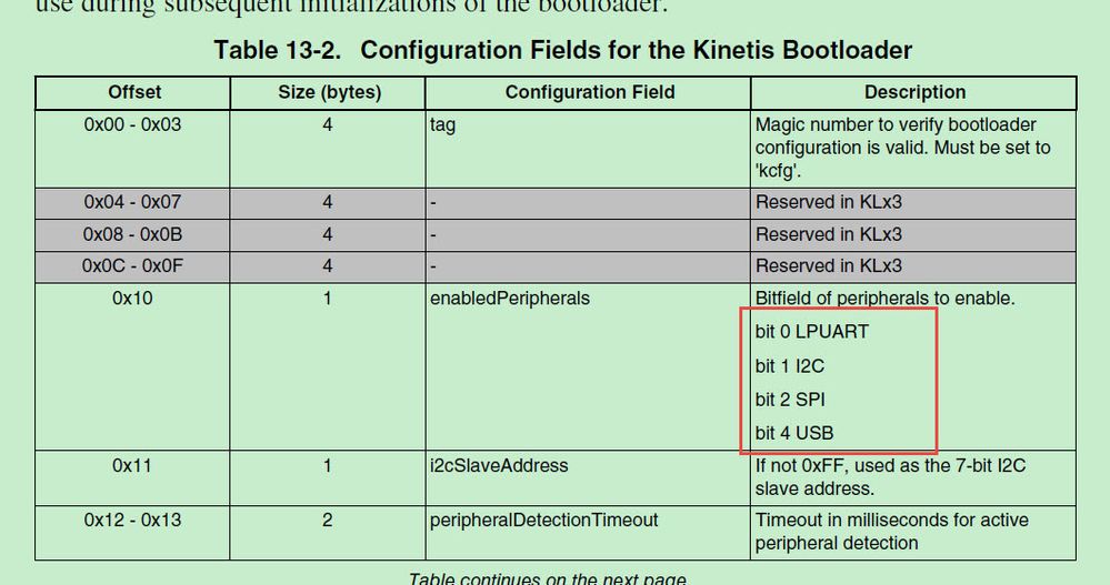

Hi All,
     I am trying to familiarise myself with KL43Z48 which is the dev platform for KL17. Although the documentations refer to Kinetis Bootloader, I cant find a target mentioning *KL43* within bootloader2_0_0/targets.  Can somebody point me to some example code and correct bootloader specific to this boar please?
Many Thanks,
Tony

tonymakkiel
- Going back to my original question, why doesn't KL43Z or KL17 have a flash bootloader? Is it because it is not implemented yet?
- I am going through the KL17 Reference Manual (KL17P64M48SF2RM). According to section 13.3.2, offset 0x10 read by bootloader, can be used to enable/disable peripherals. Although LPUART is mentioned, can't find anything about normal UART? How is it controlled?
- Where can I download the Rom bootloader ?
Many Thanks,
Tony

kerryzhou
Hi Tony,
    Flash bootloader is a segment program code in the flash, actually, you also can use the flash bootloader in KL43Z or KL17, if the chip have flash, and larger enough to put your flashbootloader and the application code, you can use the flash bootloader. Because KL43 and KL17 already have the ROM bootloader, so the KBOOT didn't give it's according flashbootloader, but you can refer to other KL series flashbootloader to write your KL43 and KL17 flashbootloader.
    About the question why you can't find the UART, just find the LPUART,  because ROM bootloader already associate with the chip internal hardware, this chip just be designed to use the LPUART. If you don't want to use LPUART, and want to use normal UART, you can choose the flashbootloader instead of the ROM bootloader.
  ROM bootloader already in the chip, you don't need to download it, you just need to downloader your application code, for details, please refer to the ROM bootloader usage in the doc folder:NXP_Kinetis_Bootloader_2_0_0\NXP_Kinetis_Bootloader_2_0_0\doc
Getting Started with the Kinetis ROM Bootloader.pdf
Wish it helps you!
If you still have question, please contact with me.
Jingjing
2,691 次查看
tonymakkiel
I am still a bit confused.
"About the question why you can't find the UART, just find the LPUART,  because ROM bootloader already associate with the chip internal hardware, this chip just be designed to use the LPUART."
Isn't normal UART also part of chip internal hardware? Did you mean to say, normal UART will be enabled all the time irrespective of the offset value?
"If you don't want to use LPUART, and want to use normal UART, you can choose the flashbootloader instead of the ROM bootloader."
Which flashbootloader are we talking about? Did you mean the flash bootloader which needs to be implemented based on the KL series?
I understand ROM bootloader is already in the chip. Is the source code of the 'ROM Bootloader' available?

kerryzhou
Hi Tony,
  1. Yes, normal UART is the part of chip internal hardware, but the ROM bootloader just use the LPUART. Because the ROM bootloader already fixed in the chip, customer just need to use the commander to call the according interface which already defined in the reference manual, and customer can't change the ROM bootloader which is not defined.
So, if you don't want to use the LPUART, and want to use other UART module, you need to write the flash bootloader code, and use the normal uart module as your application code download interface, then put it into the chip's flash. In KBOOT 2.0, there has no flash bootloader for KL43, if you want to use the flash bootloader, you can refer to KL25's flash bootloader.
2. flash bootloader can be wrote by the customer, you can refer to KL25 flashbootloader :
NXP_Kinetis_Bootloader_2_0_0\targets\MKL25Z4
The flash bootloader needs to be implemented based on the according chip, because it is just one code, and the function is to update the application code, and execute the application code.
3. ROM bootloader don't need other on chip source code except the application code.
If you want to download the application code, you can use the KBOOT2.0 given PC tools. More details, please refer to
Getting Started with the Kinetis ROM Bootloader.pdf which can be found in: NXP_Kinetis_Bootloader_2_0_0\NXP_Kinetis_Bootloader_2_0_0\doc
Wish it helps you, if you still have question, please contact me!
Jingjing
