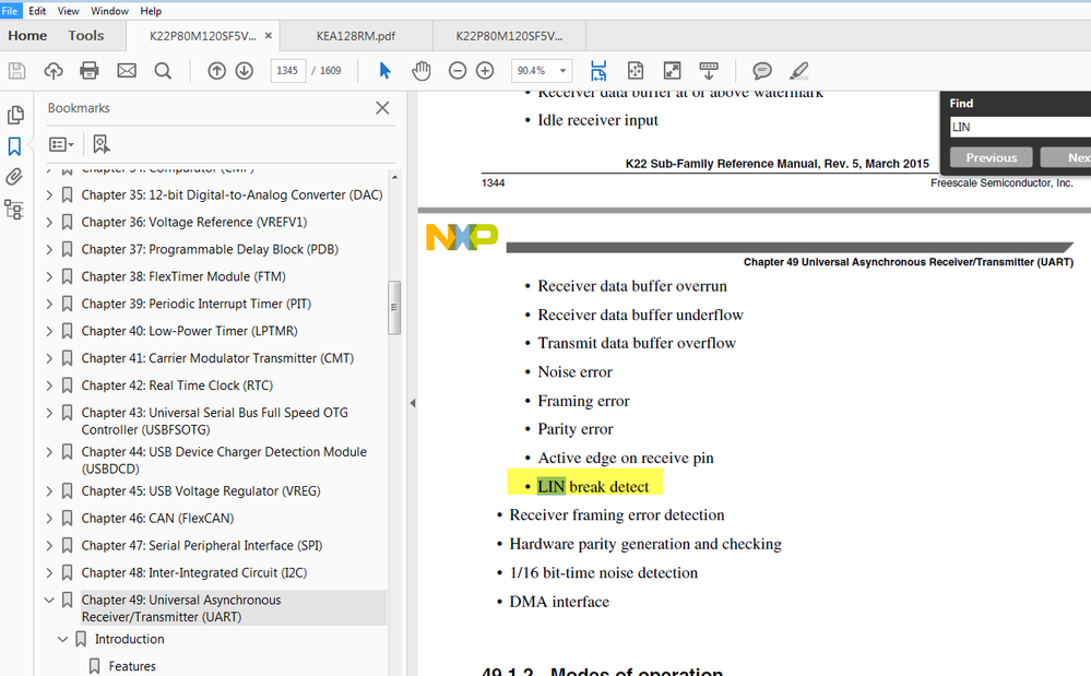

I am looking for potential alternatives for my current uC. Currently published it under Kinetis space, since there's no 'general uc' space.
Searching through datasheets and reference manuals, I can't pinpoint where to look when I want to find uC-s that have LIN protocol capability. DigiKey suggests that only MK22FN 1M0 AV LK 12 has LIN but I couldn't confirm that in the Datasheet.
I am more interested in low pin count and/or small footprint uC, 64...80 WLCSP, QFN...
Kinetis doesn't have to be the only uC family. ARM and KEIL support is more critical.
Thanks a bunch!

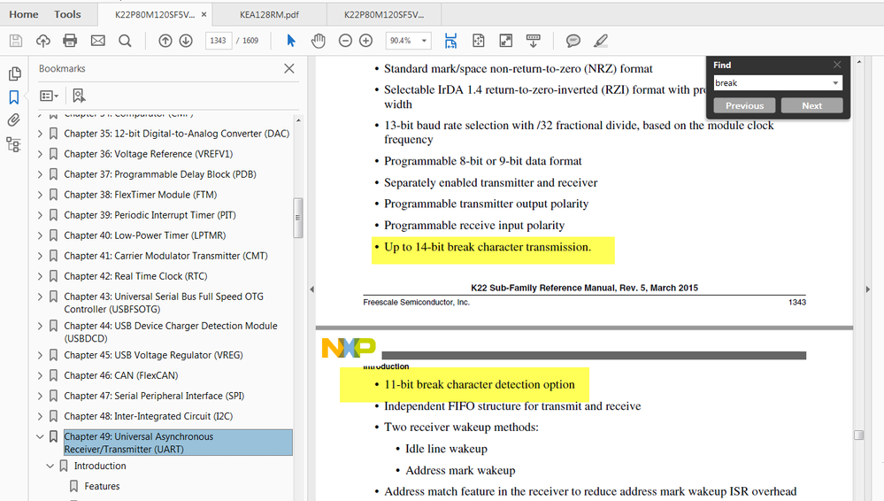

Hi Ahto Moorast,
    If you want to check whether the MCU has the LIN function or not, you need to check the reference manual, not the datasheet.
   You can check the UART chapter.
   Now, just take your MK22FN1M0VALK12 as an example:
So, it has the LIN function.
If you don't want to use this chip, you also can select other chip which it meet your other demand at first, then check the MCU which you want to select, find the reference manual, open UART chapter, check whether the UART have the LIN break detect and the break transmit function or not, if yes, it has the LIN function.

aht0
Thanks for the info!
It's a bit tedious but does the work I guess. I didn't know to look for the break condition (not so home with the LIN). When I was just looking for keyword "LIN", then most reference manuals didn't show anything. So that would be wise for NXP to add to simplify search and to tell definitively whetver it has LIN capability or not (not all U(S)ART modules do). Obscure parameters lead to more questions than answers.
