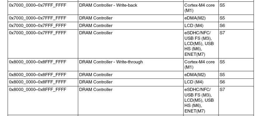

I am doing an application where performance is extremely important, causing the need for pushing the K70 to its performance limits. One of the requirements is that I need to DMA data with approximate 50 MB/s from the Flexbus to DDR memory with very low latency, while the Cortex-M4 also accessing the memory controller.
According to the K70 reference manual the DRAM controller’s slave ports can be accessed by the following master ports based on address range.
0x7000_0000-0x7FFF_FFFF
  • Cortex-M4 (M1), eDMA ( M2) can access S5, S6 and S7
  • LCD (M4) can access S5, S6 and S7
  • LCD (M5), eSDHC/NFC (M3), ENET (M7), USB (M6) can access S5
0x8000_0000-0x8FFF_FFFF
  • LCD (M5), eSDHC/NFC (M3), ENET (M7), USB (M6) can access S5, S6 and S7
Though looking in the Freescale training material http://www.freescale.com/files/training_pdf/WBNR_LA2012_K70SP.pdf?lang_cd=en page 27 it states:
  • LCD (M4) can access S6
  • LCD (M5), eSDHC/NFC (M3), ENET (M7), USB (M6) can access S7
So what is correct? Is the Cortex M and DMA limited to one slave port together, or is the reference manual correct?
If the reference manual is correct. How can I change which slave port a master ports tries with its first attempt. I want to setup the system so the Cortex-M4 always asks S6 first, and the DMA always ask S7, and they both have the highest priority on those ports. The LCD is then able to share the last port together with the USB, ENET etc.
I know about the port priority (AXBS_PRSn), and arbitration (AXBS_CRSn) registers, but I can not find any details above the other elements, which I need to know to push the K70 to it full potential.

Hi Claus,
Please check below K70 updated DRAM controller memory map info.
Related info will be updated at next version K70 reference manual soon.
Sorry for our document with incorrect info may bring any inconvenience to you.
Wish it helps.

Thanks for the update.
Just for other users running into the same issues.
Based on your answer it seems that the optimum settings is something like.
Slave port
Prio1
Prio2
Prio3
S4M2M1Don't care
S5M2M1M0
S6M4Don't careDon't care
S7M5M3M6
And regarding parking register, something like.
Slave portParked
S4M2
S5M2
S6M4
S7M5
I am looking into the DDR controller registers for the last performance tweaks.
Have a nice day.
