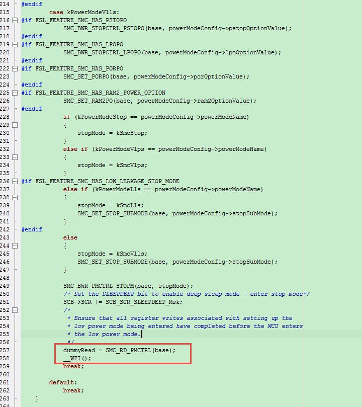

    About the dummy read, your explanation is correct! That sample code is older version for kl series, in our KSDK for KL27, it is updated with SMC_PMCTRL.
  This is the new code to enter VLLSx mode:
  Thanks a lot for your explanation!
