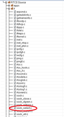

Hi @omkardixit :
RTCS_FD_SET, RTCS_FD_ZERO are defined in sock_select.c.
Please check whether this file is in your project?
make clean all and try it again.
