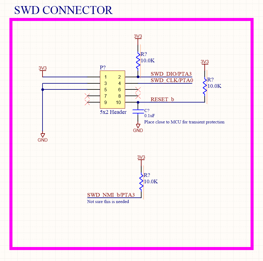

I have researched the decided that I would like to use the KL24 in my newest design.  I have created most of the schematic but it missing on how to load code onto it. I have never used the KL2x series microcontrollers before and I am not sure what lines are used to connect a JTAG programmer to.
Do I load my code directly via the USB connection?
How do I debug my code?
Complete part number that I intend to use is MKL24Z32VFM4.

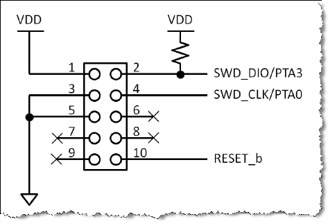

Here is the SWD debug port for Kinetis L series.

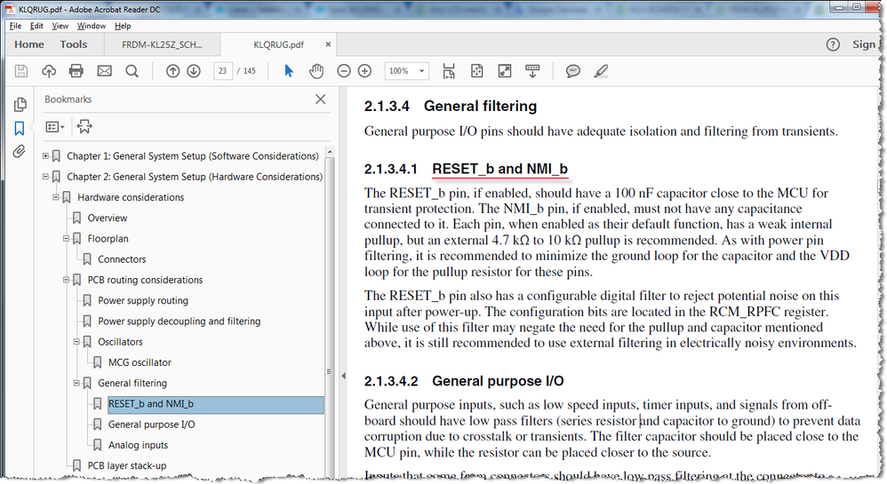

You also need to pay attention to the connection of 'RESET_b and NMI_b'.
Kinetis L Peripheral Module Quick Reference is recommend for you to read.

Thank you Mark and Robin,
Below is what I got from your input.  I wasn't sure what to do with the NMI_b pin so i tied it to 3V3 through a pull-up.
In my application I will not need a push button reset button as shown in FRDM-KL25Z_SCH_REV_E.pdf.
My circuit is low power and I plan on using the KL24 internal USB Voltage regulator to generate 3V3. It normal operating current should be around 20mA not counting what the KL24 microcontroller uses.
If you see a problem please let me know.
Thanks very much,
Lance

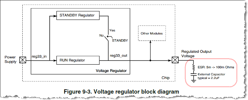

External Capacitor should be connected with Pin VOUT33.

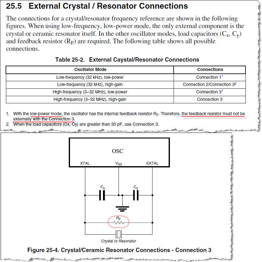

With the low-power mode, the oscillator has the internal feedback resistor RF. Therefore, the feedback resistor must not be
externally with the Connection 3.

The KL24 doesn't have JTAG - it has SWD.
Copy the SWD connection circuit from the FRDM-KL25Z diagram: https://www.nxp.com/downloads/en/schematics/FRDM-KL25Z_SCH_REV_E.pdf
There is no ROM loader in the KL24 so you need a debugger (eg. J-Link or P&E) to program it. Code debugging can be done with the same tool using a variety of IDEs - KDS is suitable.
