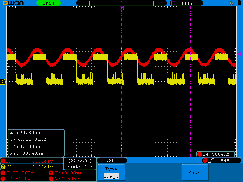

I am trying to implement "Biquad Cascade IIR Low Pass Filter Using Direct Form I Structure" using ARM CMSIS-DSP library on FRDM-KL25Z board. The filter's properties can be seen in the first screenshot below.
What I am doing is sampling the ADC, converting it to Q15 format, storing it, filtering, converting back to decimal and playing it back using PWM (with TPM module) and filtering the PWM with a capacitor and a resistor to have the analog output.

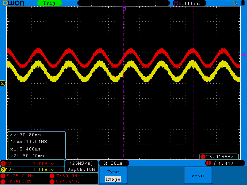

I am giving a sinusoidal signal with an offset of VCC/2 to the ADC input. When I store it and play back what I store without any modification, without any filtering and such, I get an almost perfect mach between input and output. I can also do some small modifications like removing offset and multiplying the signal amplitude. You can see the results of these operations in the oscilloscope shots.
When I apply the filtering function arm_biquad_cascade_df1_q15( ), I get strange results with different coefficient settings, but nothing near what I like. I am using Eli Hughes' wonderful tool for calculating the coefficients.
What am I doing wrong?

Is the capture with the square wave an output of the filter?  If so,   it looks like there is saturation , etc going on.
1.)
I would try running the process with trivial coefficients.   Save b[0] = 1.0 and everything else zero.    This should pass you signal from input to output.   IF that doesn't work,  then your data is not properly formatted into Q15.
You could also try b[0] = 0.5 to see your signal get cut in half.

abdullahkahrama
Thanks Eli!
You are right, ADC readings are not properly passed to "arm_biquad_cascade_df1_q15( )" function.
The problem was with the following code:
for (ctr = 0; ctr < 32; ctr--)
   FIR_src_buf[ctr] = FIR_src[ctr];
I should have increment the counter in the for loop instead of decrementing it. I can now get the input signal on the output of the filter if I set b[0] to 1 (or 32767 in Q15 representation).
